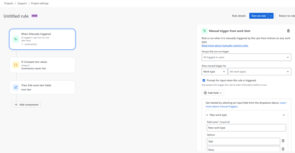

Instead of moving the ticket manually, I would create an automation which modifies the issue type.
Then remove user's permissions to move issues.
Your automation would look something like this:

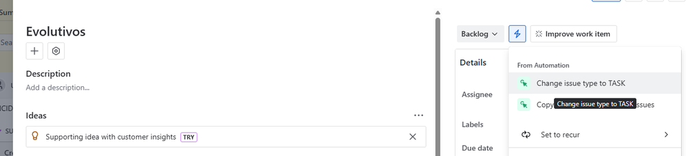

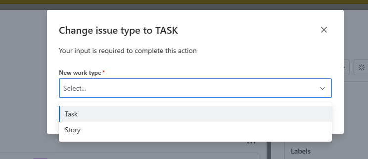

To your users it would look a bit like this:
Keep in mind, this would only work if the work item types share the current status of the issue.
