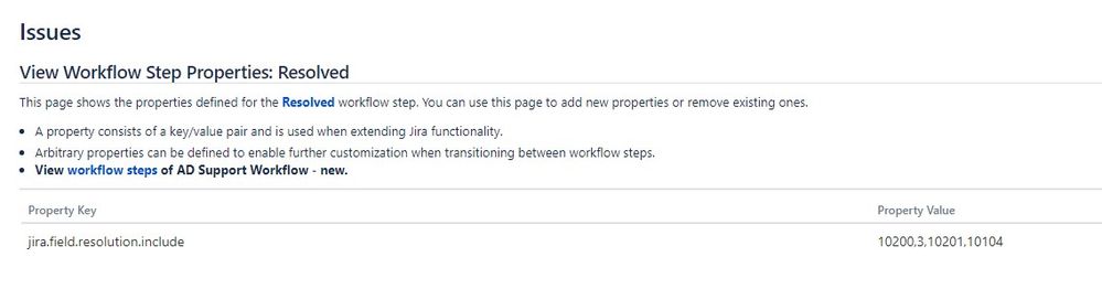

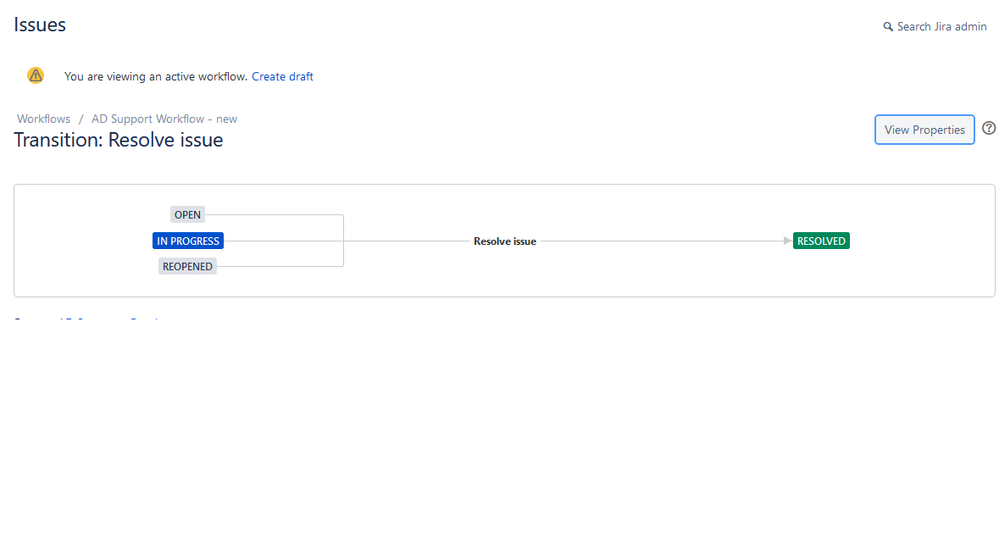

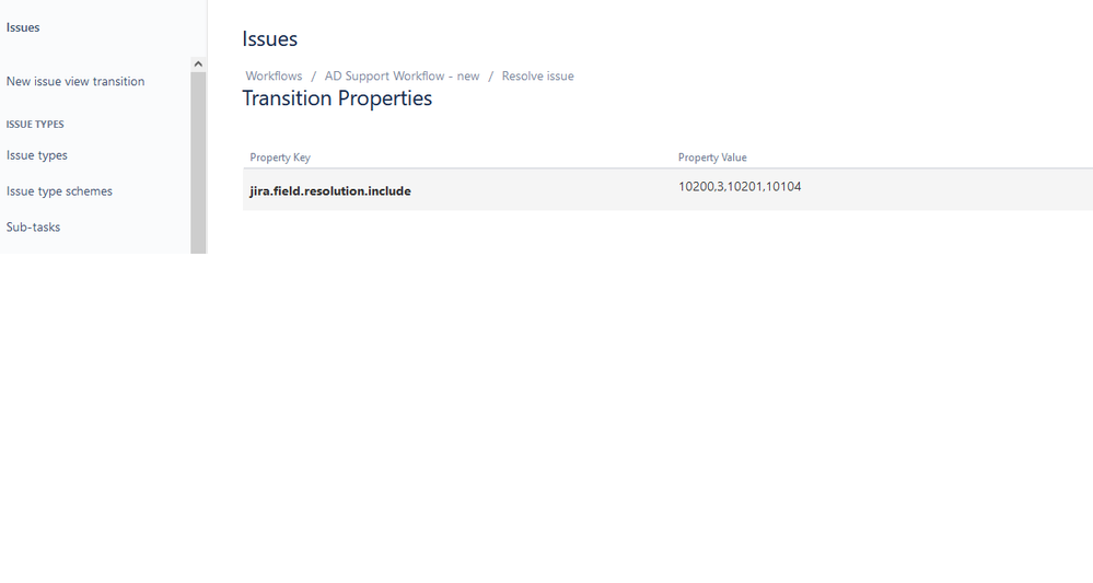

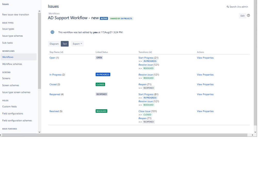

Hi Jack.  I've tried again but I must be missing a step!  I can see why it's not working now but not how to fix it!
Here is the workflow workflow.pngI click on Resolve Issue (121) transition.pngand then "View Properties" on that screen and it shows the transitions that I've deleted (several times): properties.png
On this screen I can't add/edit/delete properties.

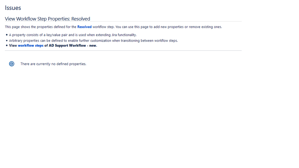

back to the Workflow screen, If I click on the View Properties on the last line (labelled Resolved(5)) then there is no value in the properties:
Thanks again

Jack Brickey
August 17, 2021
I typically work and diagram mode when editing a workflow as I find it easier to follow. With that said a couple of things to note here:
  • Your transition to resolved (Resolve issue) has the following resolution IDs: 10200, 3, 10201, 10104 listed in the include property. What resolution values do these translate to and which resolution(s) is not showing in your resolve issue screen?
  • Did you try to remove this include property (as a test) to see if all resolution values actually displayed?
  • Are you absolutely sure that the issue you were testing on applies to the current workflow? Meaning if you happen to have more than one workflow is it possible that the issue is associated with an issue type that is not using the workflow that you're currently editing?
To be honest, I feel like we're overlooking something simple here but as I don't have access to your instance I really can't determine that.
