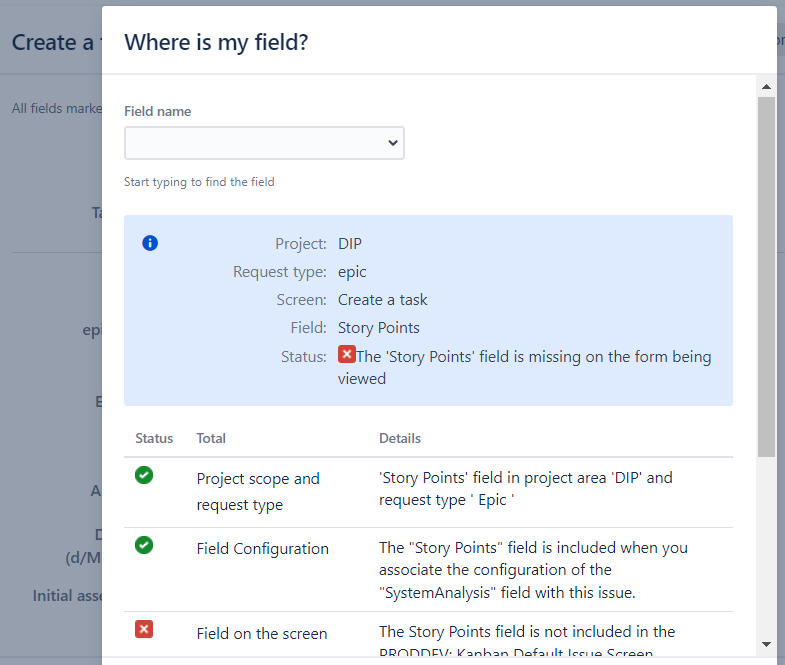

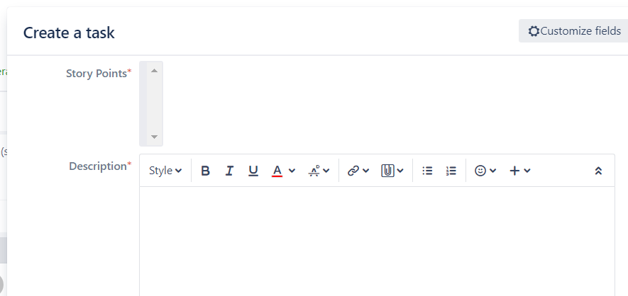

The Story Point field is displayed as required on the task creation screen. Despite the fact that it is not in any of their field configuration schemes and on any screen...
What could happen?

How have you confirmed that you are looking at the correct field configurations and screens to ensure the field should not be present?
Trudy P Claspill
August 29, 2023
What problem are you trying to solve?
Are you trying to get the field to display properly on this screen or are you trying to remove it from this screen?
If you want to remove it from the screen entirely you are also going to need to modify the Field Configuration that applies to that type of issue to make the field Optional instead of Required.. If the field is marked as Required but not on the screen, users will not be able to complete the Create process because they won't be able to fill in the required field.
