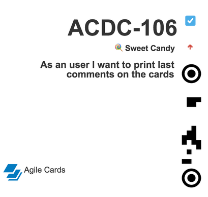

Here's a preview of the current design template we use for our own team board -
And how it is output -
The alien looking code on the right margin is for board synchronisation.
Once you have a design of your own set, it can also be saved as a template for recurring use.
For a helping start, we have a set of predefined templates for backlog refinement, planning and team boards too. šŸ‘

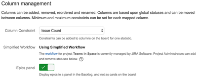

To solve this, you could either toggle the epics panel off in your column management settings (board settings menu) - img ref below
Epics+panel
With epics panel off, epics will then be displayed as issues on the board where they can be printed as any other story / task can.

Many thanks for your input! Yes, to disable the Epic panel is probably the best way to deal with the challenge to print the Epics as printout cards.

Hi @Aidy Love,
Could you please verify from which JIRA version your screenshot was taken?
As I was not able to find this option in the Column management in JIRA v7.9.1 server version, I would assume that this option is only available in cloud version.
