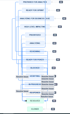

Hallo, I am an Admin and we make use of Company managed projects, Jira cloud.
Within a specific workflow, we are preventing that a story gets closed, while it still contains sub-tasks that are open/in progress/etc.
The workflow in question has a 'Condition' assigend to it that "All sub-tasks must have one of the following statuses to allow parent issue transitions: Resolved Closed or Done"
Looking at the workflow diagram, this is located at the transition to the status Resolved, Closed (green statusses)
Up until recently this was all working fine: sub-tasks needed to be completed before the main story could be closed. Yet now, for some reason, it has stopped working (while the workflow was not edited recentely)

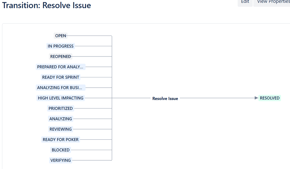

Hi @Annelise Du Piesanie
All your statuses have 'Allow all statuses to transition to this one' set up, is there any condition / validation on the one going to Resolved that would stop the user from using that transition rather than the expected 'Resolve Issue' workflow?

Thank you for the quick reply Tessa - I am able to re-create this as well. So am going to again re-check all the transistions for the workflow first
Piet Pieters
December 10, 2024
Hmm, then I indeed would think one of your transitions does not have the validator.  As @Stephen_Lugton  mentions, be sure to check your global transitions as well.
