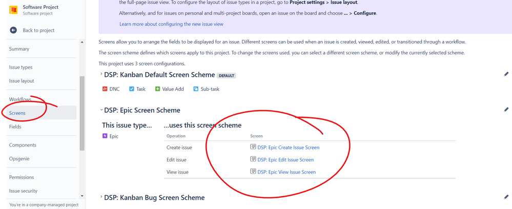

First of all you have to get rid of that specific field from the edit screen. With that said the user will be able to enter in upon issue creation and only view it within the new issue view (clicking it, will not go into edit mode).
STEP 1: To do that I would go to project settings > screens and click the individual screens to edit them and to make sure that this field will be only visible on the create and view issue operation:
In that point you would want to try open an issue of that specific issue type and try to see if that field is editable (it shouldn't be).

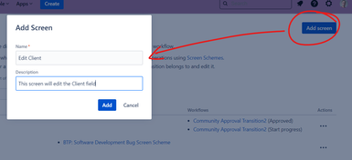

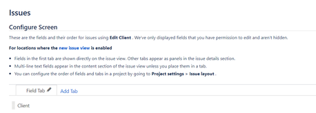

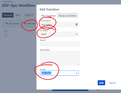

STEP 2: Go to cog > issues > screens > add screen. Give it a name and edit it so as to add your field to that screen:

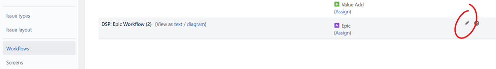

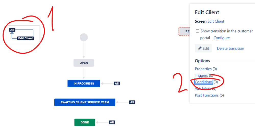

STEP 3: Next step is to edit our workflow. Head on to project settings > workflows, and click that pencil icon of the specific issue type:
  • Click diagram > add transition
  • From status: Any status
  • To status: itself
  • Name: Edit "YOUFIELDNAME"
  • Screen: Choose the screen you created in the previous step
  • Click Add

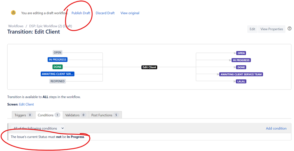

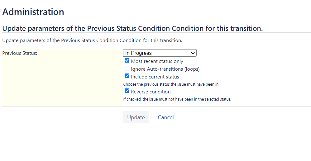

  • Click that transition and then click Conditions
  • Click Add condition > Previous Status Condition > Add
  • Configure the condition like the image below, but choose your own status to which you don't want the users to edit this field
  • Click update

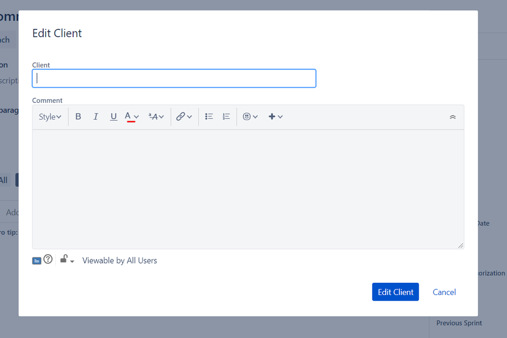

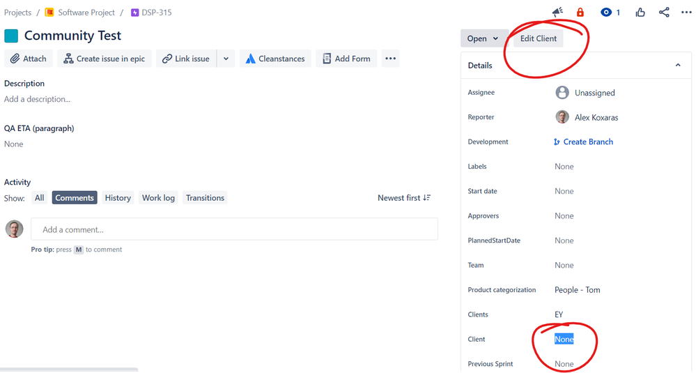

Initial status with the Edit Client transition visible.
Clicking it will popup the screen to edit it

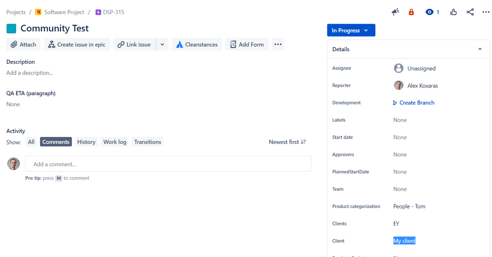

On the In Progress status the field is locked, since the Edit Client transition is not visible:
BUt on the next status (or any other status) the transition will be available
