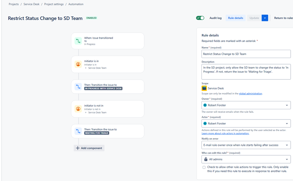

Hi which is the best way to prevent users from changing any status to in progress?
From what I can see it can be done via adding conditions on the transitions on the workflow - my problem I will need to amend a lot of workflows.
Can it be done via automation?  I used the AI automation tool which I do think is very useful and it does look correct but it does not work here is a screenshot
Can anyone advise as to why its not working and is still allowing people to change to in progress or does it have to be done via the workflow?

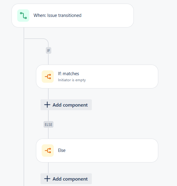

Hello, @Robert Forster .
Setting conditions to you workflow would be the appropriated approach. However, the automation might work (but not prevent).
Try changing your automation to use the "IF or ELSE" condition.
For exemple: If Initiator in Service Desk Team transtion to "In progress with service desk".... Else Initiation is not in Service Desk Team transtion to "Waiting for Triage"
Let me know if it works. :)

Hi @Robert Forster
The workflow is the correct place if you are looking to prevent an action.
Automation can revert the transition, but it's not preventing it.  The automation you posted looks like the proper approach, however, we need to see the log file to determine what part is not working for you.
