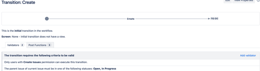

Hi @Becky Murray - Hope you are doing well. I think this is doable by adding a "validator" on the "Create" transition of the Subtask WF. Here is how you would do it -
Just make sure "Done" is not part of the parent status validator and all the status from where you want the subtask to be created is part of it. This will only work when they are creating a subtask directly under a parent.
