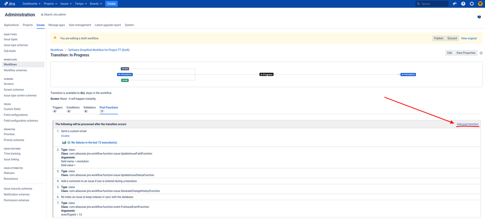

In this example, the post function is added for the In Progress transition.
1) First, go to the Post Functions and add select the Add post function option as shown in the image below:-

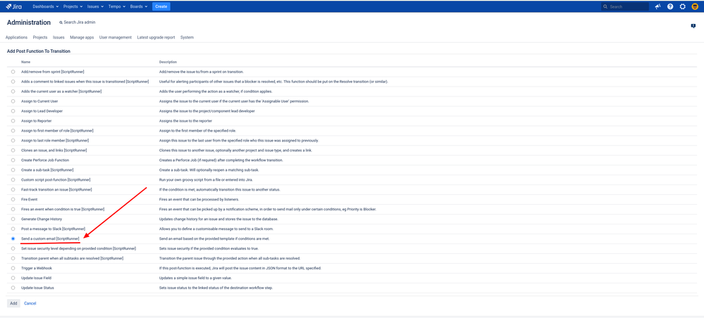

2) Second, select the Send a custom email [ScriptRunner] option as shown in the image below:-

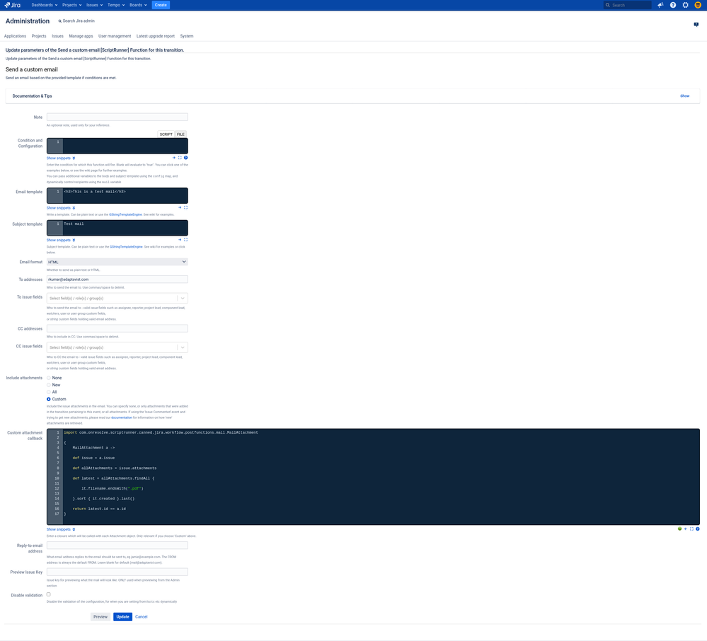

Below is a print screen of the Send a custom email configuration:-
Lastly, save the post-function and publish the changes and try to transition your issue.

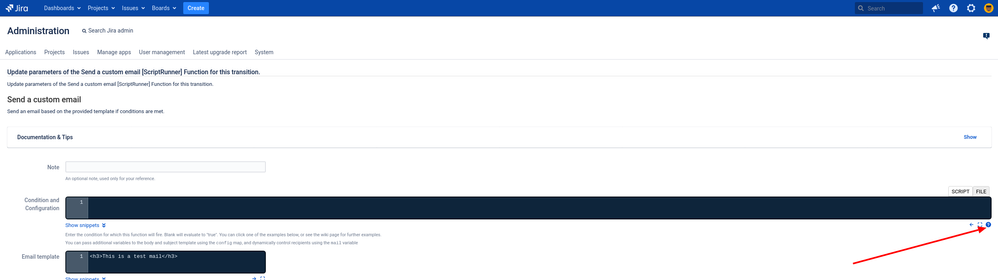

To find out the bound variables, you can click on the question mark symbol at the bottom right of the Condition and Configuration field as shown in the image below:-
When you click on the question mark, a dialog box will appear showing all the bound variables as shown in the image below:-
If you notice the image above, the customFieldManager is available amongst the list of Bound variables.
