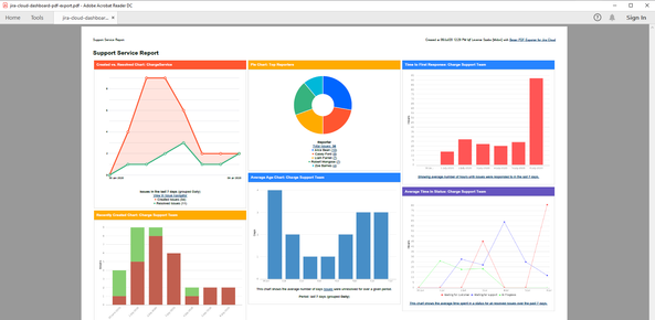

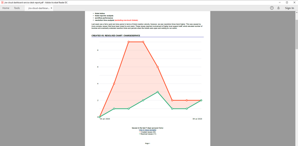

Hi @Ehsan.qashqai ,
As an alternative, you can use the Rich Text Gadget to place custom text on a dashboard.
If you don't insist on PPT, you can use Better PDF Exporter's new feature to export dashboards to PDF.
See an example output here that contains custom text:
Another example with more reporting gadgets:
See more examples here.
The only drawback I see with this approach is automating this report, as integration with Automation for Jira is not possible currently due to limitations in Jira Cloud.
