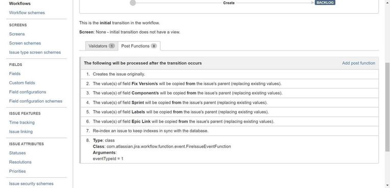

I'm attempting to use the post functions to populate fields in a subtask.  I have several that are working fine (epic link and sprint) but I have three (components/labels and fixed version) that will not inherit. Any ideas on why?

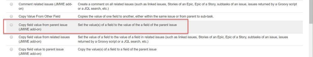

I'm using post functions on the create transition on a sub-task to pull in the fields from the parent task.   I have the JMWE add-on - where I make the selections below for each field I want to pull into the sub-task screen.  For some reason epic link and sprint work fine.   Component/s, Fix Version and Labels do not.

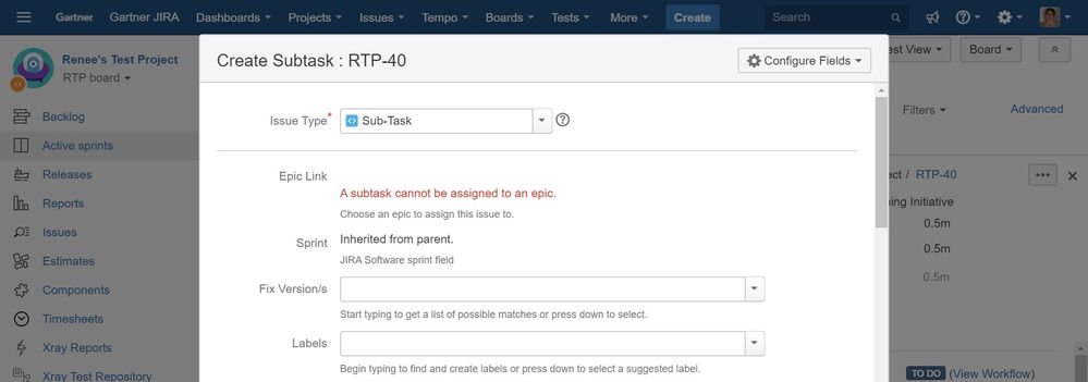

It looks like epic link isn't available at all. Interested in how you were able to make that one work.  I removed sprint from the wf post config and that worked fine.

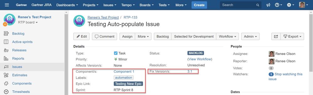

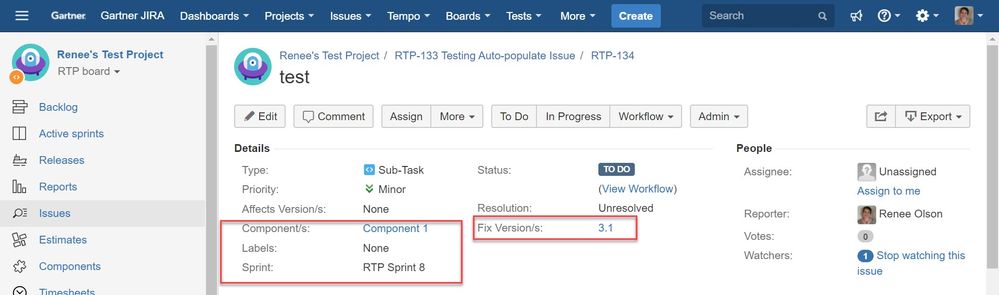

Component/s and Fix Version shows up after you save the sub-task issue.  I still cannot get labels to display.
This is my task
this is my sub task creation screen
After creation

JMWE post-function performs an operation after the transition completes. And hence you see the values after the sub-task was created. The Epic link field is not applicable to subtasks because you cannot add an Epic to a subtask. You can try adding manually to see this error. So we are left with the "Labels" field now. Which version of Jira are you using?

you probably want to remove the "Epic Link" and "Labels" fields from the sub-task creation screen, because the first one doesn't apply to Sub-tasks, and the second will be replaced by the post-function so it'll be confusing for users.

Yes, as soon as I saw the error I removed those fields completely. :)

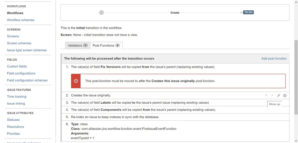

Can you move the post-function before the "Creates issue originally" post-function, publish the workflow and retry. Let us know if it fixes the issue.

It has an error if you put it before create.  That's why I moved it originally.

You moved the post-function for "Fix Version/s". Yes though it shows an error, in 7.2.3 version of Jira it should copy the "Labels" from the parent. Try and let us know. I suggest you raise a support request with us here: https://innovalog.atlassian.net/servicedesk/customer/portal/8 so that you can share more information there (short video or workflow XML etc) with us to debug the issue.

Hi, I was able to get this to work correctly.  Apparently I was copying "TO" the parent and not "from" the parent.  After I testing your fix above I noticed it was removing my label from the parent.  Then I went it and reconfigured it.  It is working now.
