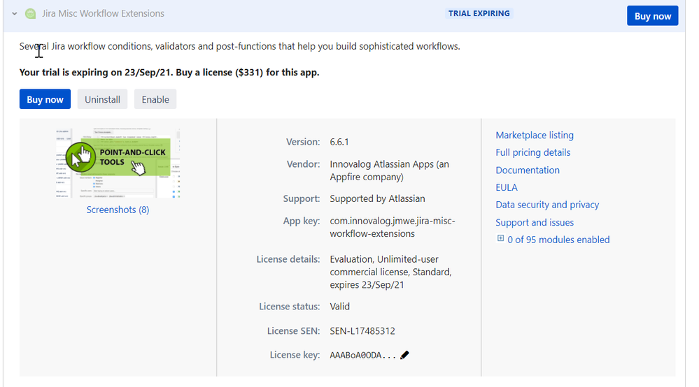

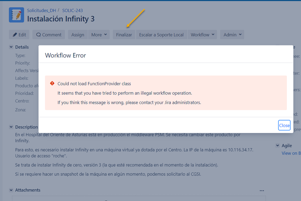

I have problems closing an Issue on a Kanban Project. I am not sure if it is affecting the plugin: Jira Misc Workflow Extension. Before extending the trial version it worked. This plugin is running on a Jira Server version. The error I get is attached.
Thank you in advance

David Fischer
September 16, 2021
If you look closely at the screenshot you shared, the JMWE app is disabled. You need to click on the Enable button.

Nic Brough -Adaptavist-
September 16, 2021
This error is typically thrown when something has gone badly wrong.  FunctionProvider class usually means "can't even load the code for the validator or post-function", but can also happen when they're badly configured, or out of licence.
But, we don't know if it is the JMWE throwing the problem.
You're not out of licence on JMWE, so it must be something else.  I would want to check the workflow for the configuration of validators and post-functions.  And ideally, the logs, as they would contain a pointer to the exact class that has failed.

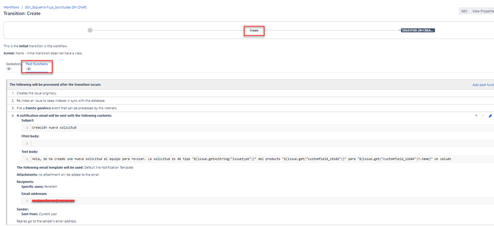

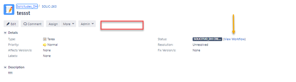

Yes, thank you I already enable it, I disabled since I thought it was the problem. However, I still see that I cannot transition when I create an issue. I send you the postfuntion and the screenshot of the issue either.
