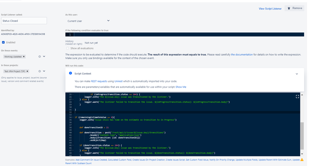

I have copied the below code to the listerner and saved: And created an issue and legged the work using Tempo. But nothing happend to the status. The issue is still in Open status only. It is not moving to In Progress or Closed status.
Am I missing something? Once we add below code, how to execute the listner? I am getting static type error as well at "def remainingEstimateValue = issue.fields.timetracking.remainingEstimateSeconds"Script Listner Error.PNG

I can confirm that the static type checking error is just a warning, where the compiler cannot fully understand the code but can be ignored and you can see more details of how static type checking works in the documentation page located here.
Also, I notice that you have configured your listener to execute on the worklog updated event when it needs to be configured to fire on the worklog created event as the worklog created event is what is fired when you add a new worklog.
Can you please update the configuration for your listener to execute on the worklog created event and to advise if this resolves your issue.

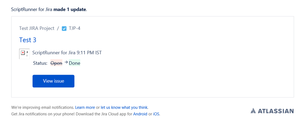

It is working as expected. Thanks a lot. But it is sending below notification to me everytime. Is there a way to control this. That too it is sending during done status only.

I can confirm that the notificaitons made by an issue being updated are triggered by Jira itself and not by ScriptRunner for Jira Cloud
This means that to avoid  emails being sent that you will need to update the notification sheme for the project to change who gets notified when an issue is updated as described in the Atlassian documentation page here.
