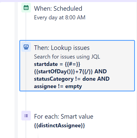

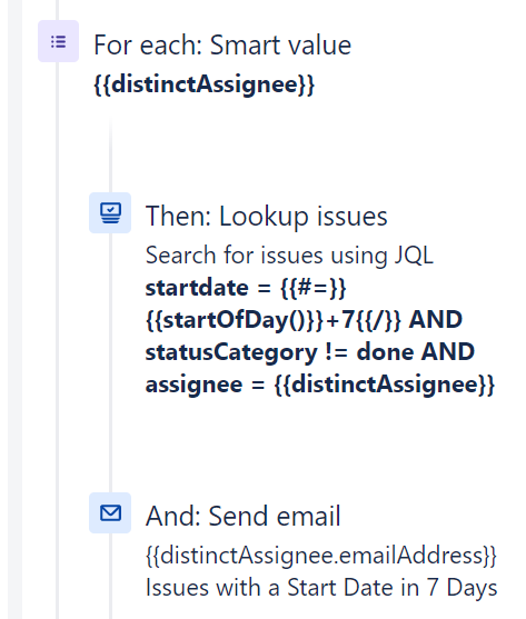

samantha_sharkov
February 14, 2023
Hi David,
Thank you very much, but I am lost. I need very specific instructions with the written code. I don't know JQL. The documentation doesn't help because I don't understand it. Here is what I have right now and my rule is failing.
