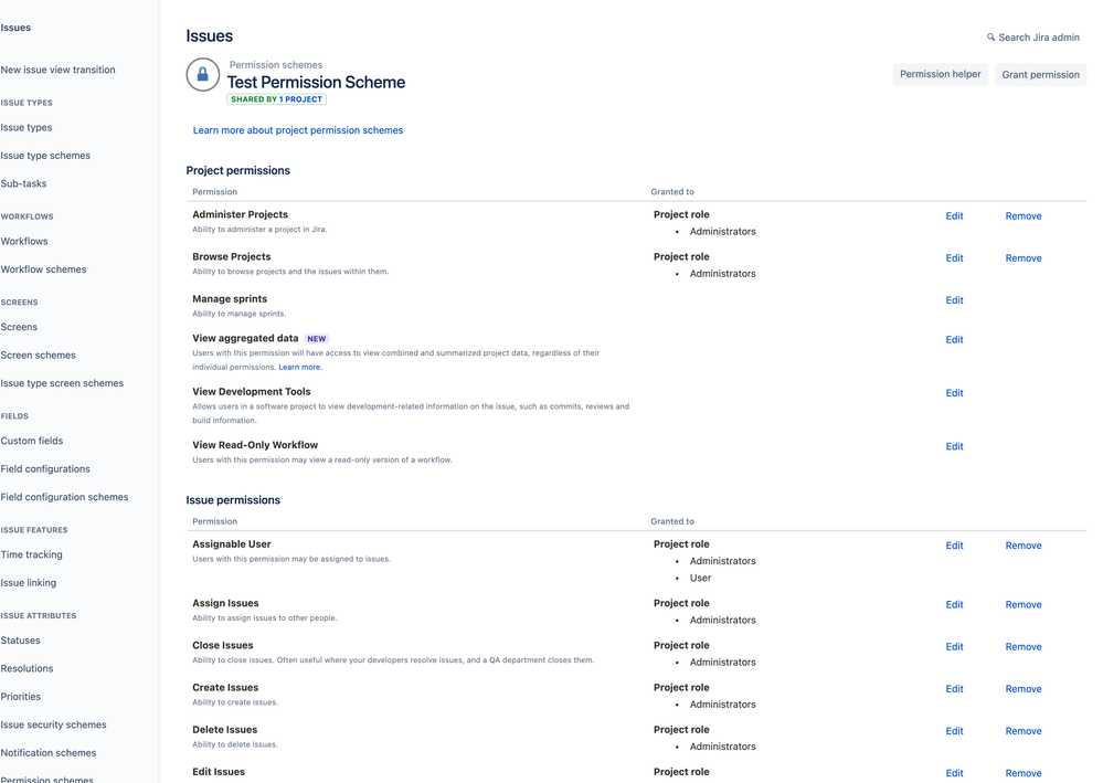

@KAGITHALA BABU ANVESH
Thank you, I've had a go at setting up the permissions. It seems to be working okay but does not give an option where you can allow a user to view only issues assigned to them. As the browse projects, permission shows the user all issues.
Any ideas?
June 29, 2021
There is something like issue security in permissions, where you can set users and levels to view issues.
https://support.atlassian.com/jira-cloud-administration/docs/configure-issue-security-schemes/

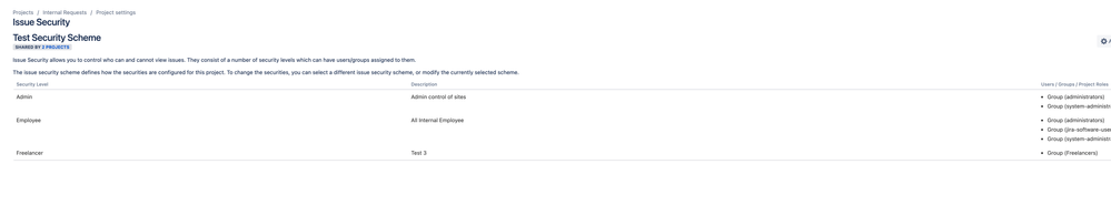

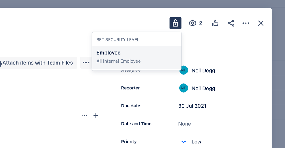

Harrison Plowright
June 30, 2021
@KAGITHALA BABU ANVESH I set up security permissions using groups as you suggested. But now as you can see in screenshots, even though I have created three security groups, only one comes up?
Thanks in advance for your help, I'm not sure what's going wrong?
