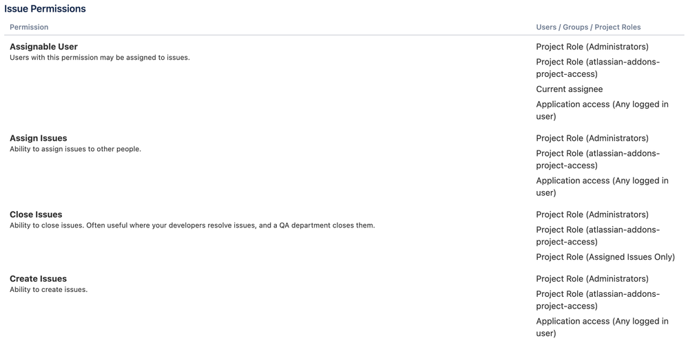

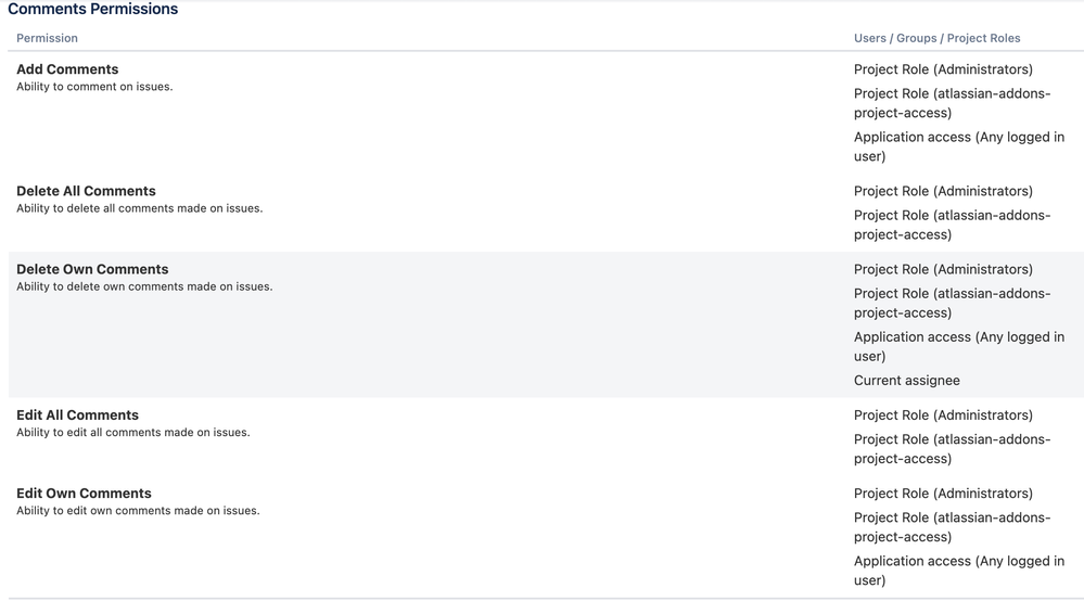

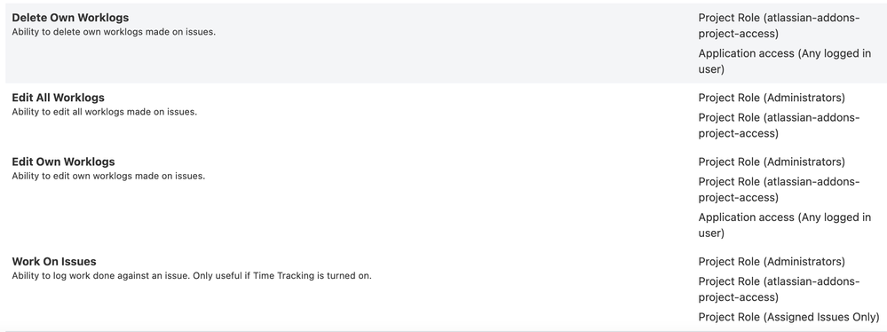

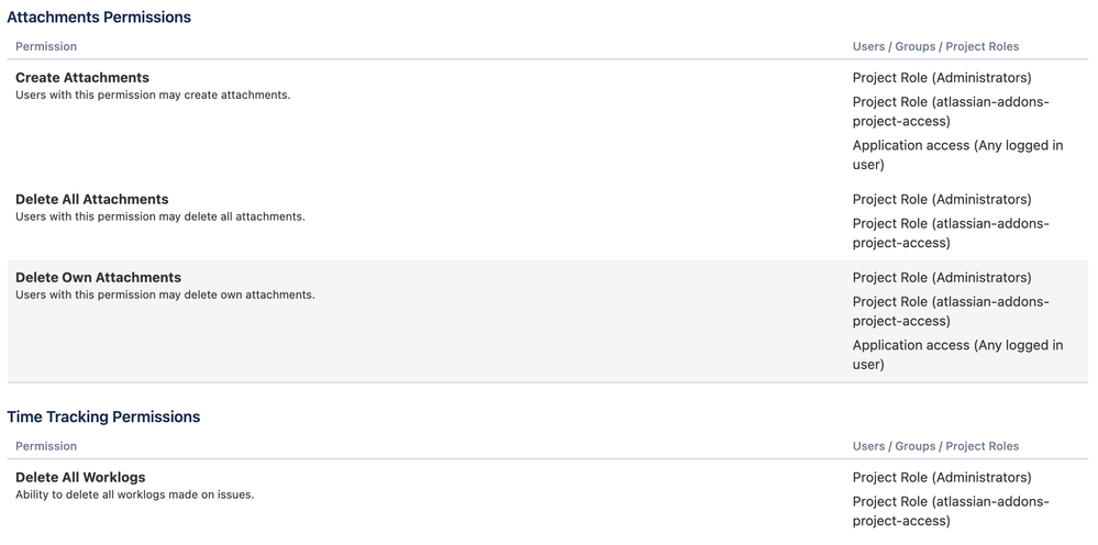

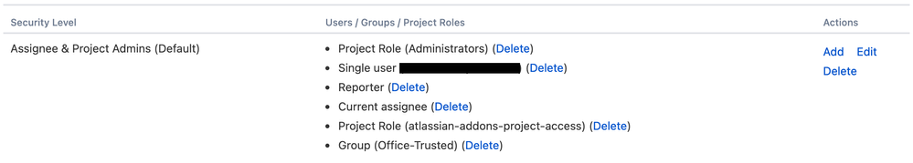

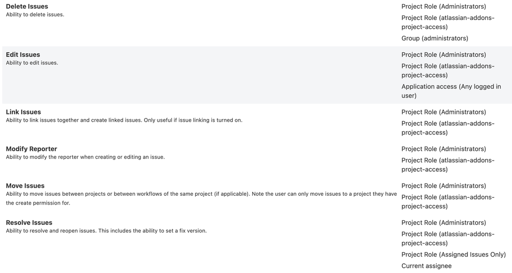

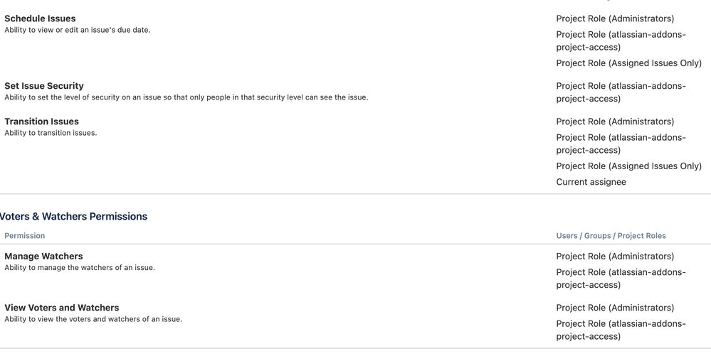

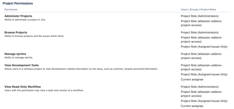

Elvina Janušonytė
December 19, 2020
Hey Monika, thank You for the feedback.
please see below. Security scheme  ( was trying with "current assignee" and adding " Project: Assigned issues only" as well):
Then permissions board. ( I know that there is bug that when adding to "browse project" everyone can see it if assigned "current user"), i was trying however many multiple combinations. with only " current assignee" OR with only" project: assigned issues only", and then both)... It is really frustrating. only thing what i got is that i get to see the board or i don't get permission to see it at all.
Screenshot 2020-12-19 at 14.50.53.pngScreenshot 2020-12-19 at 14.51.15.pngScreenshot 2020-12-19 at 14.51.33.pngScreenshot 2020-12-19 at 14.51.43.pngScreenshot 2020-12-19 at 14.51.52.pngScreenshot 2020-12-19 at 14.52.04.pngScreenshot 2020-12-19 at 14.52.14.png
