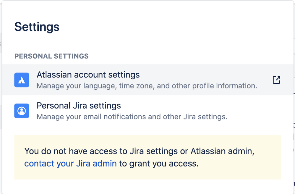

Taylor Hetherington
July 9, 2021
My admin sent me the screenshot showing I have Admin permissions but when I click on the cog in the top right-hand corner the message in the light yellow box still tells me I don't have permission.
Jack Brickey
July 9, 2021
what you’re missing is training/experience. 😉
The cog is reserved for site admin/Jira admin users not project admins. as a project admin you can access “project settings” in a given project. The link I provided to workflows above should guide you and how to access an edit given workflow.
