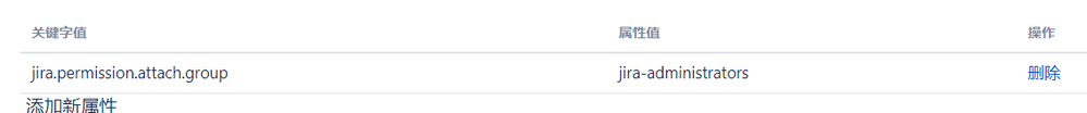

Thank you for your reply. I've seen your answers to similar questions on this site. I try to set it like this:
Set the attribute in the closed state of the workflow: JIRA permission. attach. group--jira-administrators
or
jira. permission. attachdeleteown. group--jira-administrators
jira. permission. attachdeleteall. group--jira-administrators
However, the result is that attachments cannot be deleted in all States of the workflow. They are visible and can be added. And has no effect on the problem link.

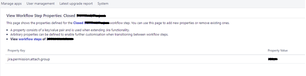

please could you provide a screenshot of the place in which you added that property?

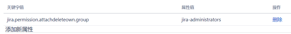

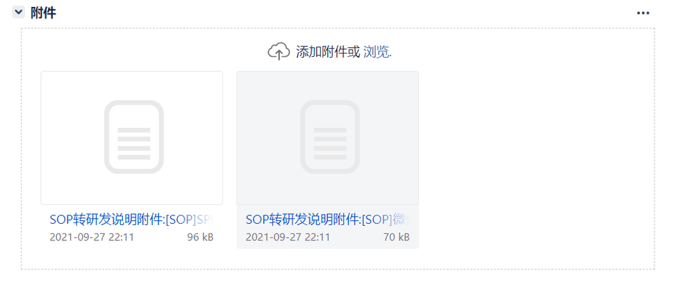

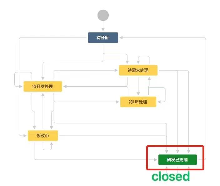

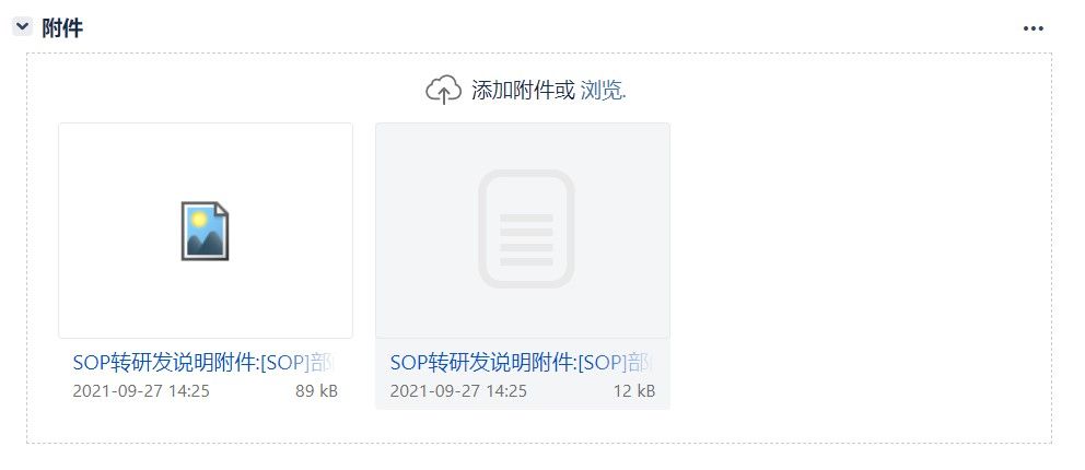

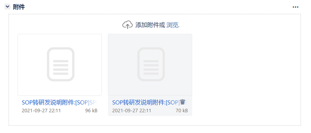

1、My workflow is like this
2、Work properties are configured in the work status "R & D completed"
3、Attachment view for JIRA Administrators group
4、Attachment view for non JIRA AdministrFor the same workflow, the properties are set in the "R & D completed" status
The non JIRA Administrators group still has permission to add attachments。

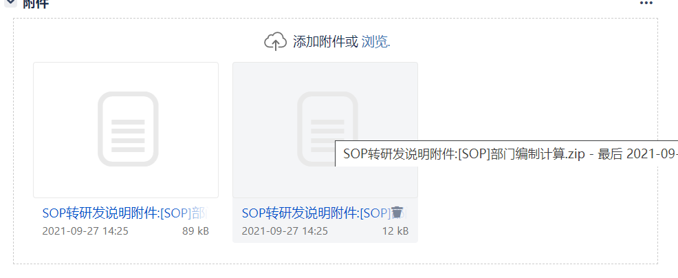

1、For the same workflow, the properties are set in the "R & D completed" status
2、Attachment view for JIRA Administrators group
3、Attachment view for non JIRA AdministrFor the same workflow, the properties are set in the "R & D completed" status

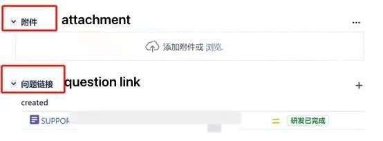

In short, I hope that when the problem is "R & D completed", the attachment and problem link have no permission to modify, add or delete except the administrator group, but they should be visible.

Please add the following properties as step properties in your status:
  • jira.permission.attachdeleteall.group - jira-administrators
  • jira.permission.attach.group - jira-administrators
It should prevent all users (out of jira-administrators) to attach or delete files just for that status and not for all the others.

Thank you. The add and delete permissions of attachments are working. How to set the add and delete permissions of problem links?
