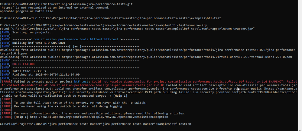

I'm trying to perform JPT, its giving me below error, can someone help me out...Thank youJPT Error.png

Hi. Did you retry later to make sure if it's not an intermittent problem? If it's permanent then most likely your JRE CA store misses trusted root certificate that's used by packages.atlassian.com which is DigiCert. You can try following the steps described here https://docs.oracle.com/cd/E19906-01/820-4916/geygn/index.html to install DigiCert certificates listed here: https://www.digicert.com/digicert-root-certificates.htm. Refer to the following screenshot to get the names of the certificates to import:

Thank you for the clarification
