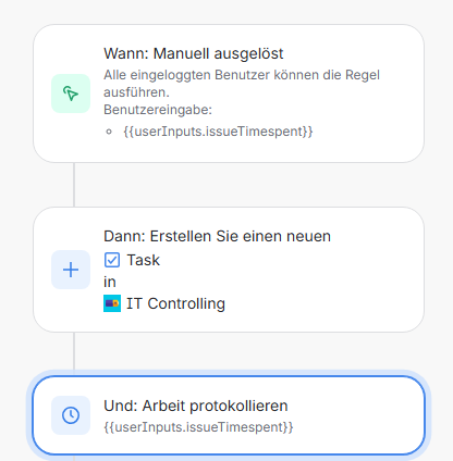

Martin Hirsch
September 17, 2025
Das ist die Automation bisher. Allerdings habe ich das Problem, dass die Zeit dann immer auf den auslösenden Vorgang protokolliert wird, statt auf den gerade erzeugtenimage.png

Thanks for that information, @Martin Hirsch
When you create a work item in the rule, and then want to access it for updates, the rule needs to branch to it first:
  • trigger: manual, with your input
  • action: create work item, for the task
  • branch: to most recently created work item
    • action: log work
Like Martin Hirsch likes this

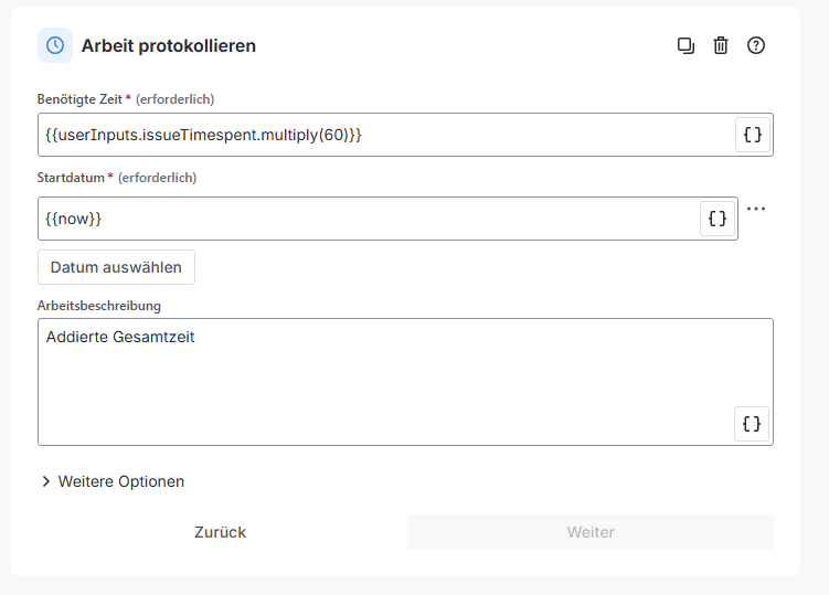

But another little problem: My smartValue is in hours and if i log work, there are minutes. How can i change this? My resolution doesnt work.

Hi @Martin Hirsch
First, when your question is resolved, please remember to "accept" the answer.  That will help people with a similar need find solutions faster.  Thanks!
Next, please try adding the units of measure for minutes to the end of that expression:
{{userInputs.issueTimespent.multiply(60)}}m
