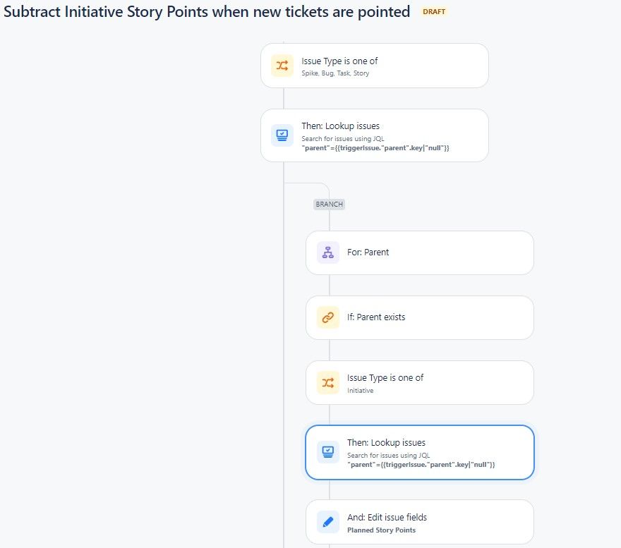

My goal is to be able to subtract Story points from an Initiative when a new story/task is pointed underneath the Initiative and Epic.
Some background: My org uses the "Parent" field to in stories to identify the parent epic.  And Epics also use the same "Parent" field to identify the parent Initiative.
The hierarchy I am working with is
1. Initiative
2. Epic
3. Story/Task
I am essentially trying to use automation to subtract "Planned Story points" from the Initiative when a new story has "Story points" added to it.  And I am trying to accomplish this without touching the parent epic.
I have tried a few different methods including below. Branch to the parent seems to affect the Epic and not the Initiative.  Would anyone know the JQL I can use to essential branch to the Parent of a Parent?

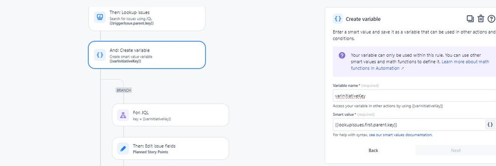

Jeffrey Crime
February 23, 2024
Hi!  Thanks for the quick response!  I tried going with your first suggestion with the test rule using the JQL - {{issue.parent.parent.key}} to reference the Initiative from the triggered story.  No luck.
As far as your second suggestion, I input the suggested logic into the automation, however I am getting following issues when trying to execute:
Lookup Issues
There was an error executing a search during custom value definition: .
Custom Smart Value JQL Search: "(Jira-1) AND (project in (10199))" - Error in the JQL Query: Expecting operator but got ')'. The valid operators are '=', '!=', '<', '>', '<=', '>=', '~', '!~', 'IN', 'NOT IN', 'IS' and 'IS NOT'. (line 1, character 11)
Branch Rule/ Related Issues
Error searching for related issues. This is most likely because the following issues don't have a related issue of the type you specified. Try narrowing your search to only include issues that contain links to related issues:
Jira-2: "((key = ) AND (key != Jira-2)) AND (project in (10199))" - Error in JQL Query: Expecting either a value, list or function but got ')'. You must surround ')' in quotation marks to use it as a value. (line 1, character 9)
Could it be the way I am branching into the Parent key perhaps?

Bill Sheboy
February 23, 2024
I see a typo where the name of your created variable does not match the name of the one used in the branch.
Also, the JQL for the branch should be:
key = {{varInitiativeKey}}
And not just the variable.
Would you please show the details of your create variable action to confirm this?  Thanks!

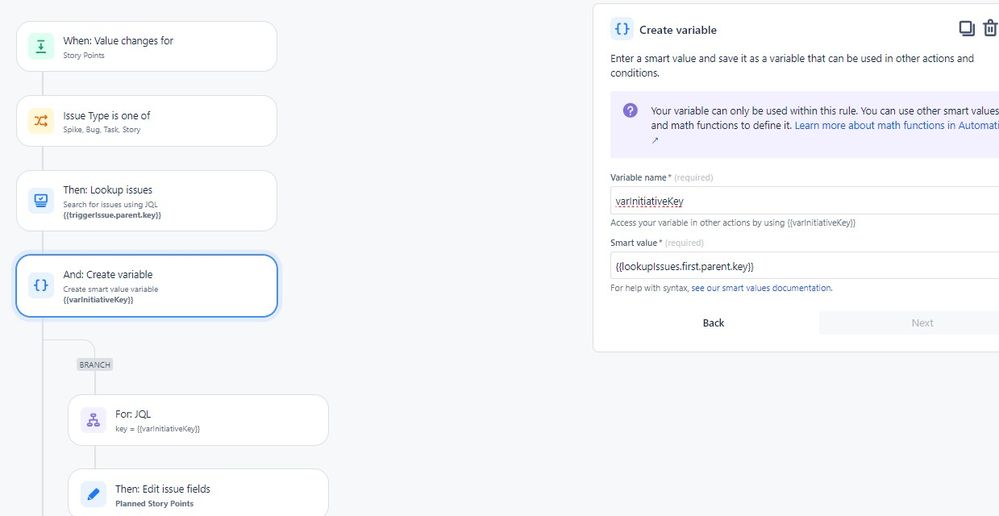

Jeffrey Crime
February 26, 2024
Thanks for the point out!  Fixed any typos I saw.  Perhaps it could be the Smart value I am inputting?
New to Jira automation so i'm interested in how it works.  Thank you!

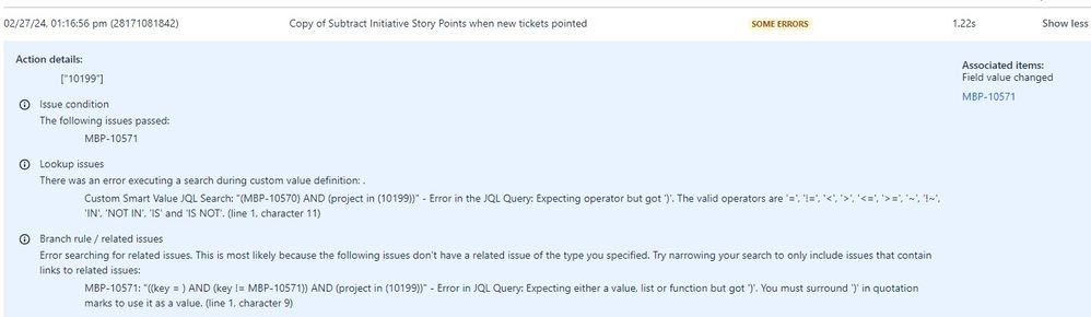

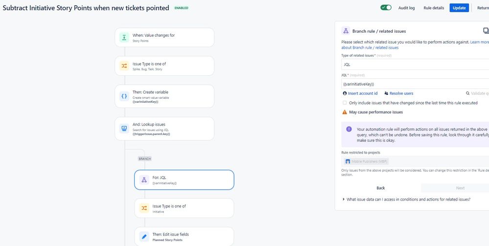

Jeffrey Crime
February 27, 2024
Sure.  I posted the audit log as well as the full automation sequence.  Thanks

The lookup issues action in the third step of your rule has invalid JQL.  That should be:
key = {{triggerIssue.parent.key}}
Jeffrey Crime
February 27, 2024
It is Working now!  Thanks so much for your patients and help!
