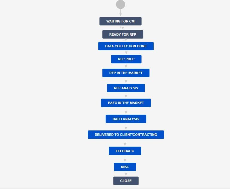

Hello ,
Below you can find workflow we are using for parent issues and sub-task issue . We have multiple sub-tasks for single parent issue when all sub-tasks status is "Ready FOR RFP" then parent status has to be updated with that status .  In this way once all sub-task's status are updated to now automatically parent issue hast to update with that status.
Can anyone guide me with the right script to achieve this task as we have only option to use script runner only.
Regards,
Mahesh

I have adapted one of the script I use.
You should change the name of the transition and verify the name of the status of subtask (the name is: if at least one subtask is still at this status do not transition the parent issue).You need to put this as a post-function of the subtask workflow on the transition between "waiting for cm" and "ready for rfp".
If the transition of the parent fail for any reason, the subtask will still make the transition. Some change at the end is needed if you want it to make error instead.

Mahesh Kallepalli
January 22, 2020
@SITTER Adrien
I highly appreciate for your quick response let me test this on my workflow .
One more question do we need to implement this on every transition's ?
SITTER Adrien
January 22, 2020
If you want to do at all transition yes.
Be careful this code works only because it is the first transition of the workflow. You have to change the filtering condition if you want to make it work at an other transition.
This code is looking for any subtask that is in "Waiting for CM", if there is at least one it does not make the transition of the parent.
But if you want for exemple to make it for the transition between "bafo in the market" and "bafo in analysis" you need to select every subtask that are between "Waiting for a CM" and "bafo in market" included.
May be there is a way to compute it using the workflowManager the easiest way is still to write all of them with a collection in the code. But this means than any modification in the workflow will need to make change in every postfunction.
