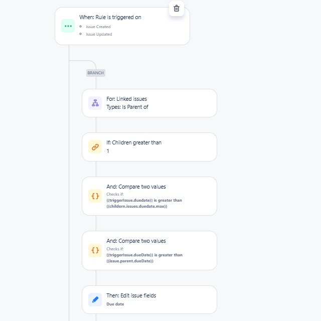

Hi, My JQL skills are not so good but I need help on creating an automation for:
1. A custom created field called milestone
2. I have linked tasks and sub-milestones using 'a child of' relation to the 'is parent of ' milestone
Automation rule:
1. Update 'is parent of'linked issue due date when
2. 'is Child of' linked issue due date is greater than 'isparentof' due date
AND
'ischildof' due date is maximum among the linked children due dates

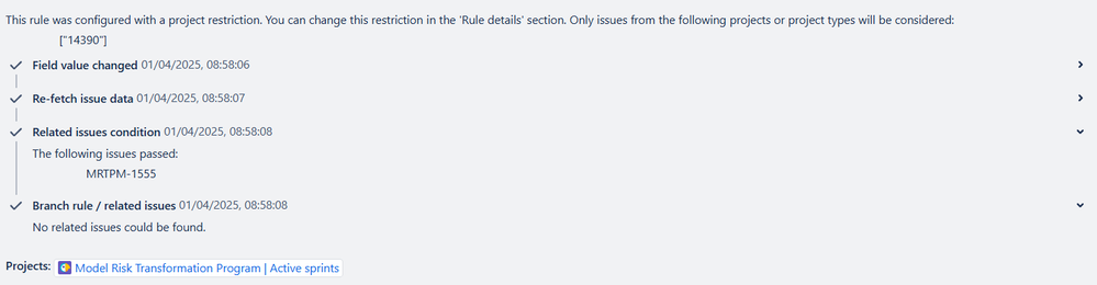

I applied this rule but this doesnt work as per the audit log I have attached. Can you let me know why this could be the case?

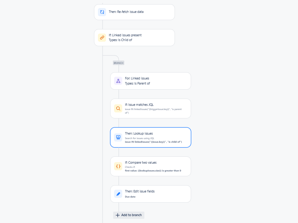

Praveen Ravichandran
April 1, 2025
Bill Sheboy
April 1, 2025
Reviewing the branch shown, it does not match what I suggested (using JQL), and it is not returning any issues (as shown by the audit log).
Please update the branch as needed to branch to the correct "parent" linked issues and then re-test.
