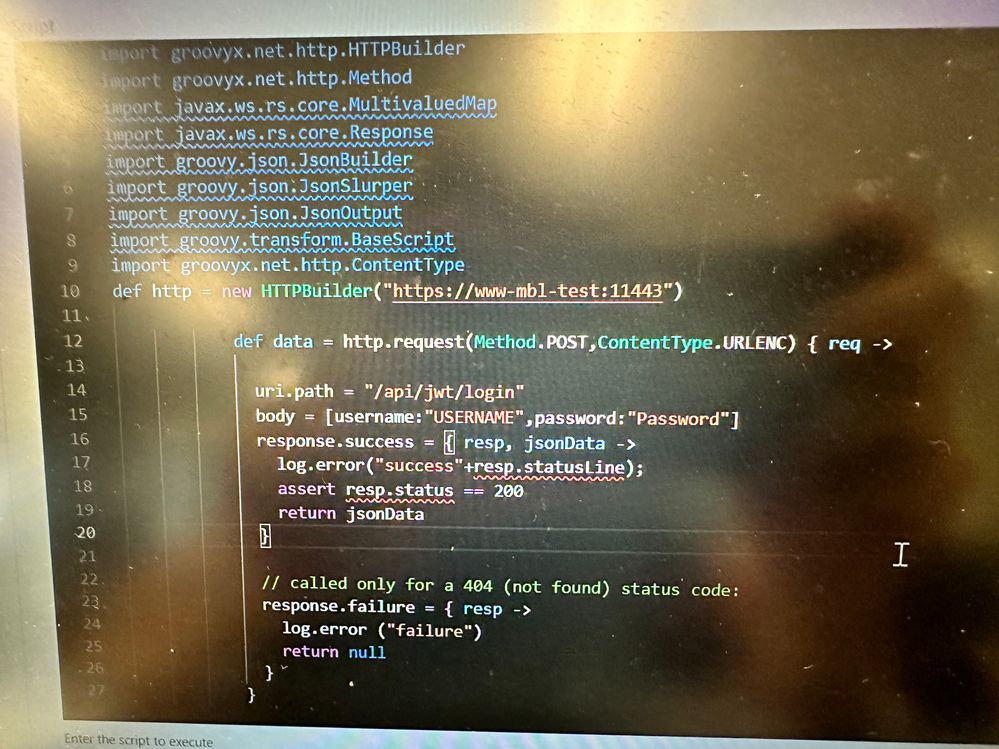

×I’m trying to get jwt token in helix/bmc remedy using script console but it always outputs to null without logs. I’ve hidden the confidential informations

import groovyx.net.http.HTTPBuilder
import groovyx.net.http.Method
import groovyx.net.http.ContentType
def http = new HTTPBuilder("https://www-mbl-test:11443")
def data = http.request(Method.POST,ContentType.URLENC){ req ->
uri.path = "/api/jwt/login"
body = [username:"USERNAME", password:"PASSWORD"]
response.success = { resp, jsonData ->
log.error("success"+resp.statusLine);
assert resp.status == 200
return jsonData
response.failure = {resp ->
log.error("failure")
return null
