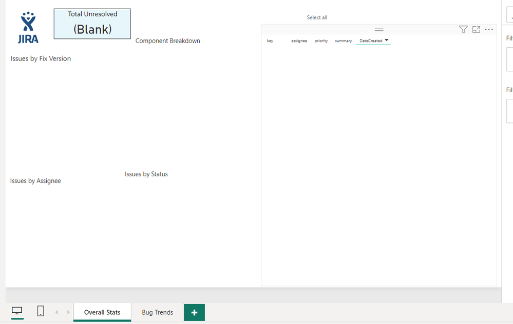

BenWade
November 28, 2023
I have no idea why it won't load the data.
When I first open pbit file the window pops up to put jira url.
So I put it this way:
https://companyname.atlassian.net
Then I go to data source settings-> edit permissions-> Basic-> username(email) and password. and then I refresh the report but nothing happens.

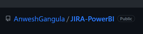

Jira PBI content pack you can get from github.
just google: "visualize jira data in powerbi github" and in the first link you will find it.
