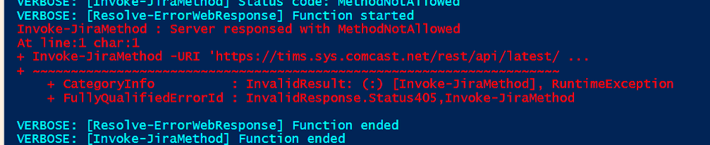

further tried passing it to Invoke-JiraMethod throws below error. do we have an option to update the resolution field.
$headers = @{
self = "https://$($jiraserver)/rest/api/2/resolution/10202"
id = 10202
description = 'The issue has been resolved'
name = 'Resolved'
$body = $headers | ConvertTo-Json -Depth 3
$URL = "https://$($jiraserver)/rest/api/latest/issue/1232324"
Invoke-JiraMethod -URI $URL -Method Post -Credential $creds -Body $body -Verbose

You can't update the Resolution field directly. You need to create a post-function in the transition that will update the Resolution field when you invoke the transition.
If you have issues that are "Closed" but have Resolution = Empty, you need to create a new transition from Closed to Closed that will set the resolution field to a value. You can then invoke the transition either from a bulk update or from your PowerShell script to set the resolution.
