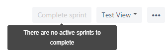

Can you please share the error displayed when hovering over the Complete sprint button? Something like that:

The message displayed information about lacking manage sprint permission. I can't share the screenshot, because I've completed this sprint (the team can't wait anymore for finding a solution for local admin privileges problem). I made a double check and found out that local admin has correct privileges and there are only issues from his project in current sprint. Moreover as I mentioned before he was able to complete another sprint from the same board
