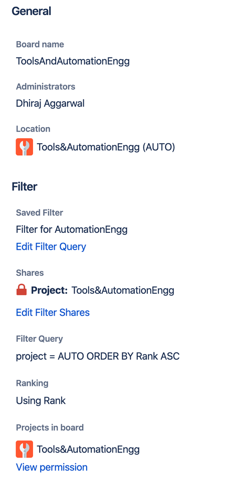

Hi @Dhiraj Aggarwal
Your board settings might hiding 'Done' issues.
Can you try going to Board settings -> Filter query and confirm if Done issues are not excluded.

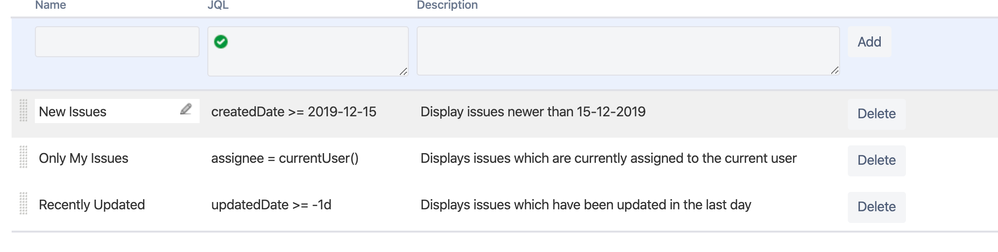

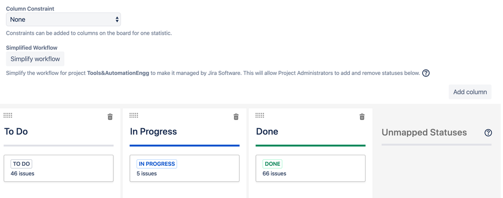

Carlos Garcia Navarro
January 13, 2020
@Dhiraj Aggarwal  can you attach a screenshot of your board settings-> general and also board settings-> columns?
Dhiraj Aggarwal
January 13, 2020
Screenshot 2020-01-14 at 11.55.15 AM.pngScreenshot 2020-01-14 at 11.57.00 AM.pngScreenshot 2020-01-14 at 11.57.19 AM.png
