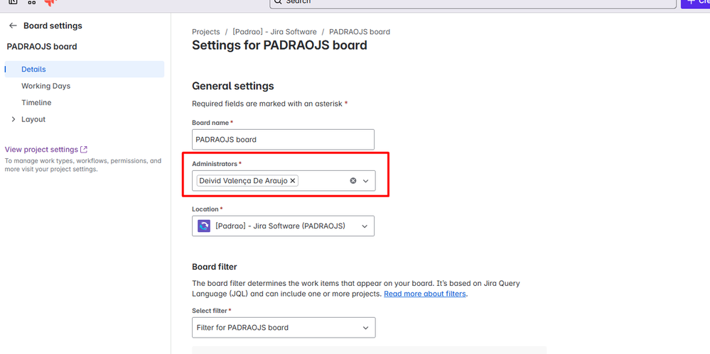

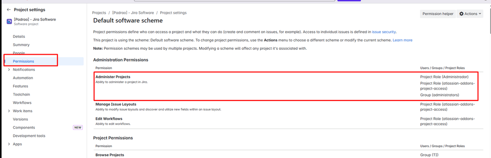

Deivid Araujo
May 26, 2025
Hi @Mark Salamon
As @Rishabh Jhawar  and @aakash_vijaywargiya  mentioned, deleting an issue requires specific permissions. It's important to note that being a Board Administrator does not automatically grant the permissions needed to perform this action, as Board Administrator and Project Administrator are distinct roles.
To clarify:

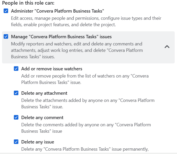

Karin van Driel
May 27, 2025
@Mark Salamon
Are you using a company managed project? Most of the responses I see here are for a company managed project, if you are using a team managed project, check the Access section, see what role you have and then check what permissions that role has been assigned. It is in a check box list format, rather than a permission scheme in this kind of project, looks like this :
If you have the standared Admin role in the project, then you should have Delete access, but if your role is different, you might need to add the permission.

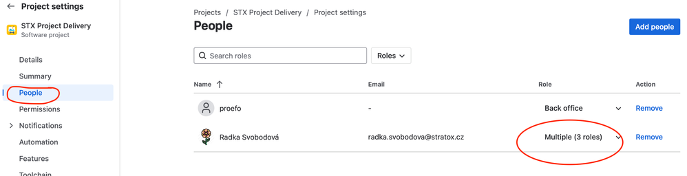

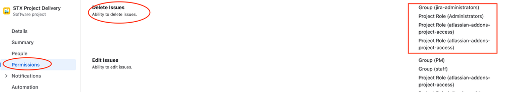

Radka Svobodova
May 26, 2025
in permissions you see the roles and groups who have the rights to delete issues > than in people you can check, if you have the precise role or assign it to you (if the permission scheme is based on roles, groups are different admin rights)Screenshot 2025-05-26 at 20.10.45.pngScreenshot 2025-05-26 at 20.12.26.png

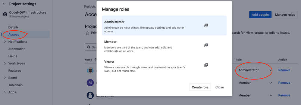

May 26, 2025
if you're on team managed project look to setting to access - and assign yourself also the role where delete permission is

Paul James
July 12, 2026
Atlassian doesn't seem to believe in making the user experience intuitive or consistent.
To be able to delete a task (permissions) is now under:
Space Settings - Access - Add people - Administrator
Then you can delete tasks.
