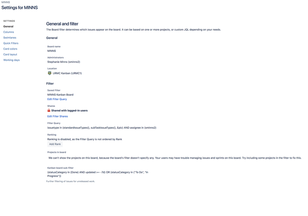

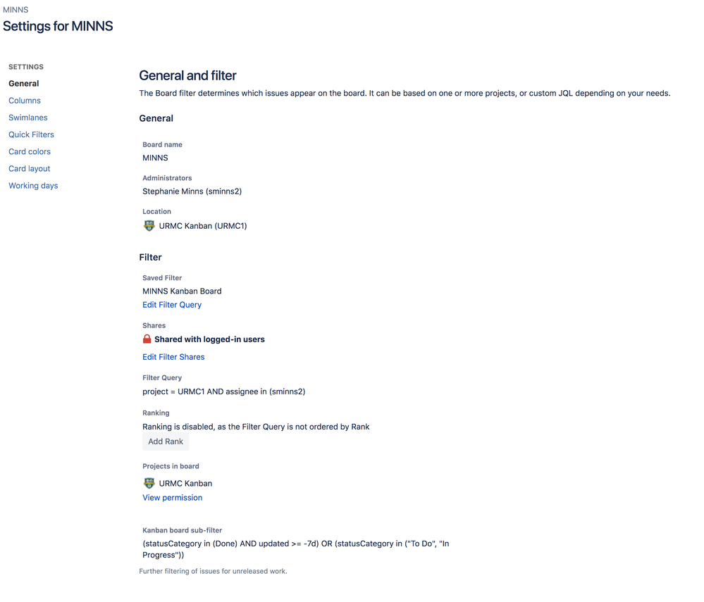

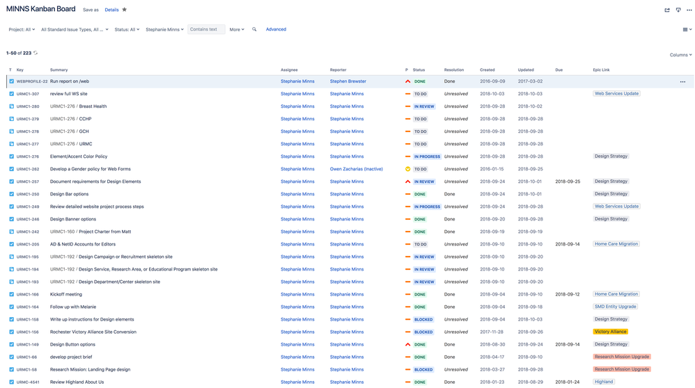

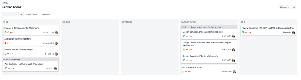

I am having the same issue. I've attached screenshots of each of my screensScreen Shot 2018-10-03 at 12.35.16 PM.pngScreen Shot 2018-10-03 at 12.35.25 PM.pngScreen Shot 2018-10-03 at 12.35.57 PM.pngScreen Shot 2018-10-03 at 12.36.07 PM.png

@Stephanie Minns, can you articulate what you mean by the "same problem". I just want to be sure I know what your issue is here. If it is that you see different issues between the Kanban and the filter list please not the sub-filter in your board settings, i.e.

Thanks for the reply @Jack Brickey. I am viewing a Kanban board that I created and set the swimlanes to be based on epics. As you can see in the first screenshot, there are only a select few tasks... but in the last screenshot the number of issues that actually should be displaying is very different, there are many more. Why aren't all of these issues showing on the board?

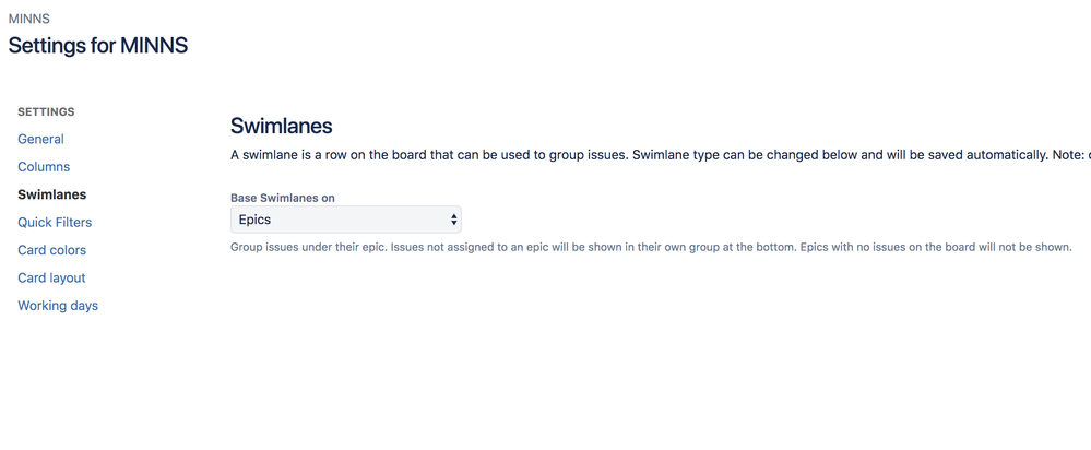

First you say you want to set swimlanes to epics but currently your board does not appear to be setup that way? Go to Board settings > Swimlanes and choose Epics.
Second, regarding few issues being displayed, it is because some issues are being filtered out by the sub-filter. Per the sub-filter, any "Done" issue that was last updated more than 7 days ago will not show. If that doesn't in-and-of-itself account for the delta check your quick filters.

Swimlanes are set to epics, and even if i remove the subfilter, it still doesn't show anything different other than older done tasks.Screen Shot 2018-10-03 at 3.23.46 PM.pngI really appreciate the help!

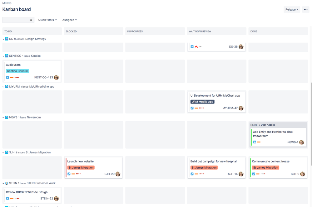

Here is the same board with swimlanes by project instead of epics. you can see that the epics are there. No quick filters are being applied, either. I'll start from scratch I guess and see what happens.

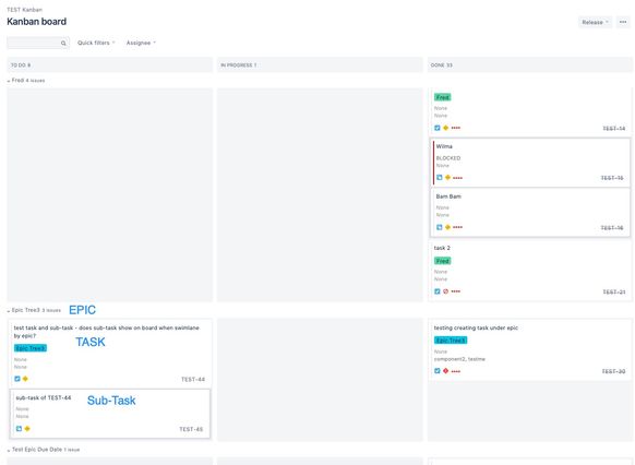

@Richard Neuhaus, sub-tasks will show on board by epics as below.

@Jack BrickeyYou can see my epics as "Kentico General", "URM Mobile App", etc. That screenshot is showing what the board looks like when the swimlanes are divided by PROJECT.
So, correct. If I choose to divide swimlanes out by anything other than Epics, I see all tasks.

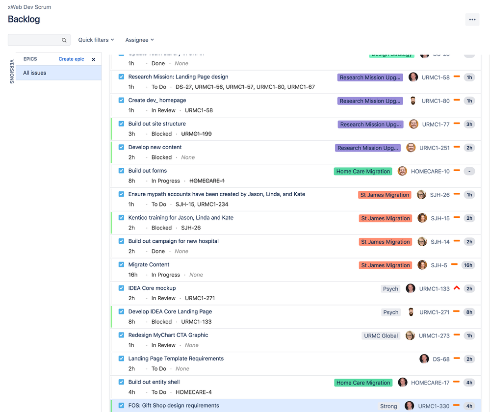

Just noticed my Epics are also missing from the backlog... in the attached screenshot you can see each Epic Link on the tasks, but the list of Epics which should be populated in the left column just says "All Issues".Screen Shot 2018-10-12 at 11.28.23 AM.png
