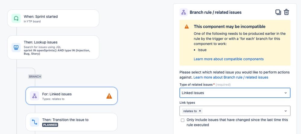

I have tried multiple approaches but keep getting 'component incompatible' errors.

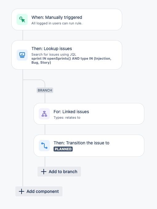

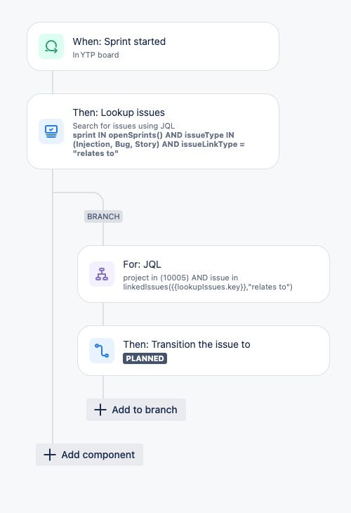

This is what I expect would work (but doesn't):
And this works, but as soon as I change manual trigger to sprint started, it stops working. I confirmed by sending myself an email that Lookup issues returns the same list of issues before branching off:
I cannot figure out why changing the trigger results in an incompatibility issue.

That error message can be a bit confusing, and what it means is a rule step needs an issue and none is present.
For your rule triggered on Sprint Started, you want to access the issues in the sprint.  And so normally the rule would branch to the issues in the sprint.  But you also want to access the issue which are lined to those issues in the sprint, and branches cannot be nested.

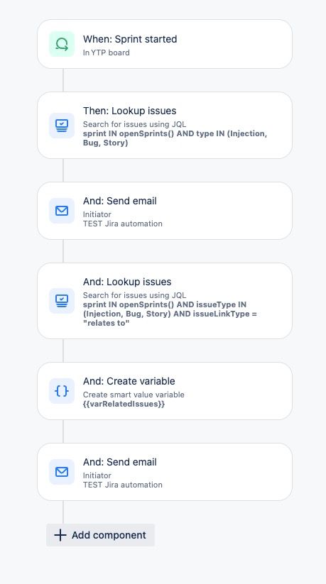

  4. I am not sure how to branch off this? There is advanced branching (with another smart variable assignment) and branch rules / related issues.
^ I also tried (type.name,"relates to")

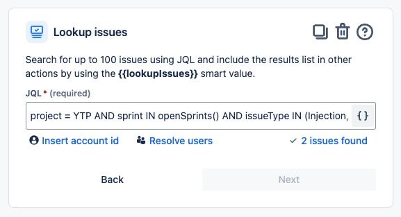

I can confirm that the lookup works:

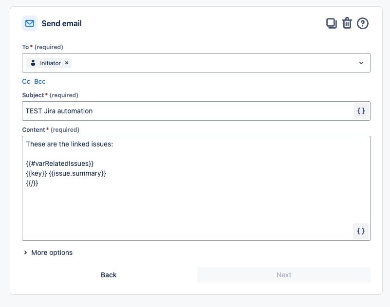

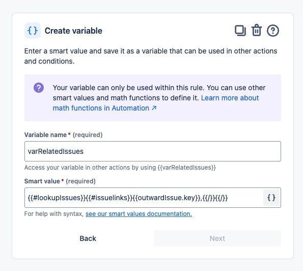

But when I try to create the smart variable and debug it by sending myself an email, I get an empty list:
So it seems that something is going wrong there. I would love to try and fiddle with it, but I am not sure how I can test and see what's happening.
Bill Sheboy
August 19, 2024

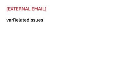

A variable is text and has no issues or objects, such as the attribute "key".  When trying to send that email, please just try {{varRelatedIssues}} by itself.
Please post an image of the audit log details showing the rule execution as that may help explain why the issues are not transitioning.

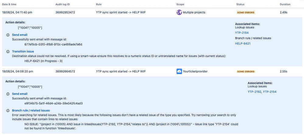

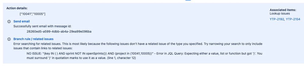

I tried and this is the log:
I also tried setting up something simple with alternative code and get no output. Seems the main challenge is that you can't double branch... first for issues in Sprint, and then for each linked/related issue.

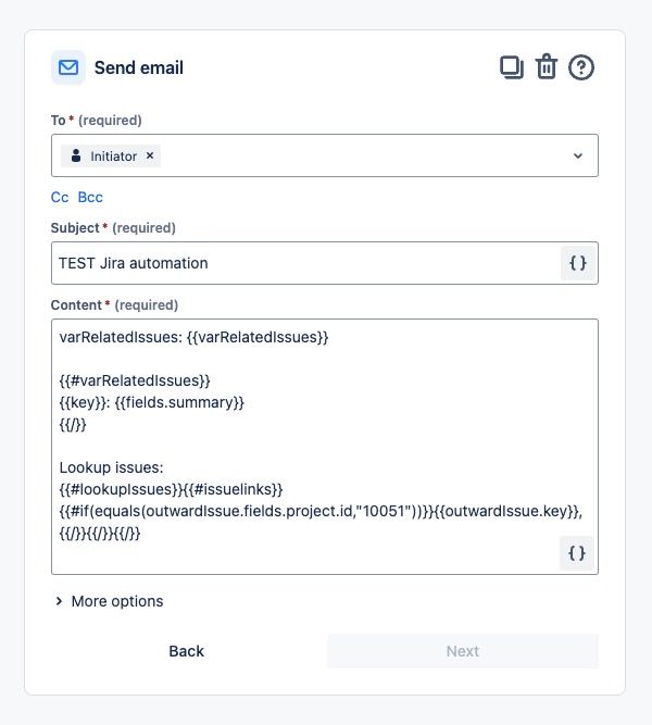

Bill Sheboy
August 19, 2024
I see four problems to fix in what you showed:
#1) Your rule's definition of the variable varRelateIssues is incorrect.  That may be seen in the audit log as there are no keys listed within the parentheses for the JQL.
It should be this:
{{#lookupIssues}}{{#issuelinks}}{{#if(equals(type.name,"Relates"))}}{{inwardIssue.key}}{{outwardIssue.key}},{{/}}{{/}}{{/}}
Within the smart value for issuelinks, the name of the link type is just "Relates" and not "relates to" as you tried, so it had no matches.

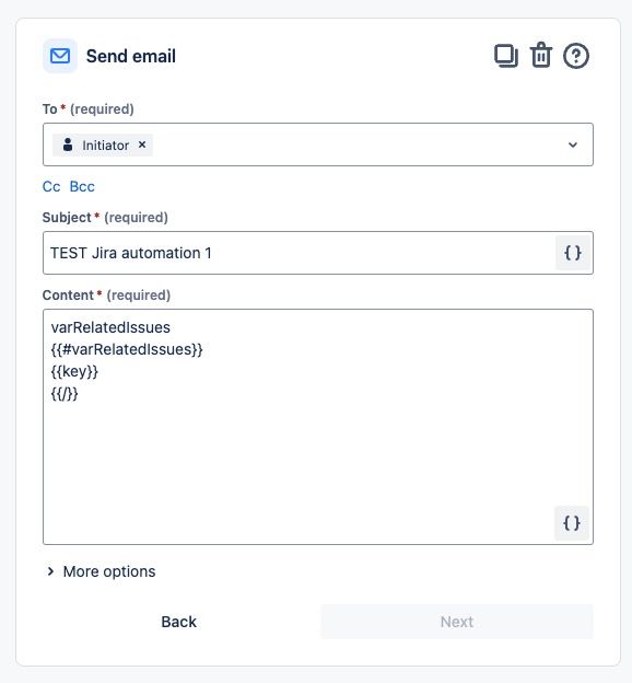

#2) Once again, {{varRelatedIssues}} is text, and so this will not work and may be removed from your email:
{{#varRelatedIssues}}
{{key}}: {{fields.summary}}
#3) Your rule appears to be accessing issues in multiple projects, and so it must use  multiple-project in scope to "see" them.  Your Jira Site Admin will need to make that change in your rule details as it is an admin setting.
#4) In your email, I see you are trying to filter the lookup issues, on the project id of the linked issues.  That is not possible...
When an issue is loaded for lookup issues, it contains all of the fields for the loaded issue.  But it does not contain all of the linked issues' fields, and so the project id is not visible yet.  (This applies for the issuelinks, subtasks, and parent smart values.)  If automation did load all of the fields, you could imagine a scenario where one linked issue pulled in all of the data in Jira site!
This is another reason we were building dynamic JQL with {{varRelatedIssues}} so the other field data could be loaded.

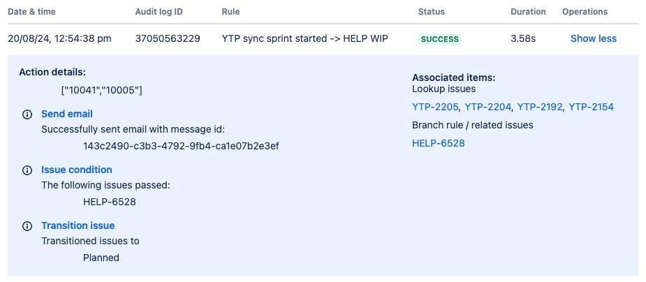

I got my first 'success' run, so very happy with that!
For testing I have added 4 issues with a link to the sprint. The problem is that only 1 is transitioned to Planned. I suspect the varRelatedIssues is not selecting all 4 of them.
See the audit log below. Do you have any idea what might be causing this?

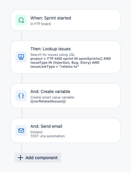

Also please post an image of your current, complete rule for context.  Thanks!

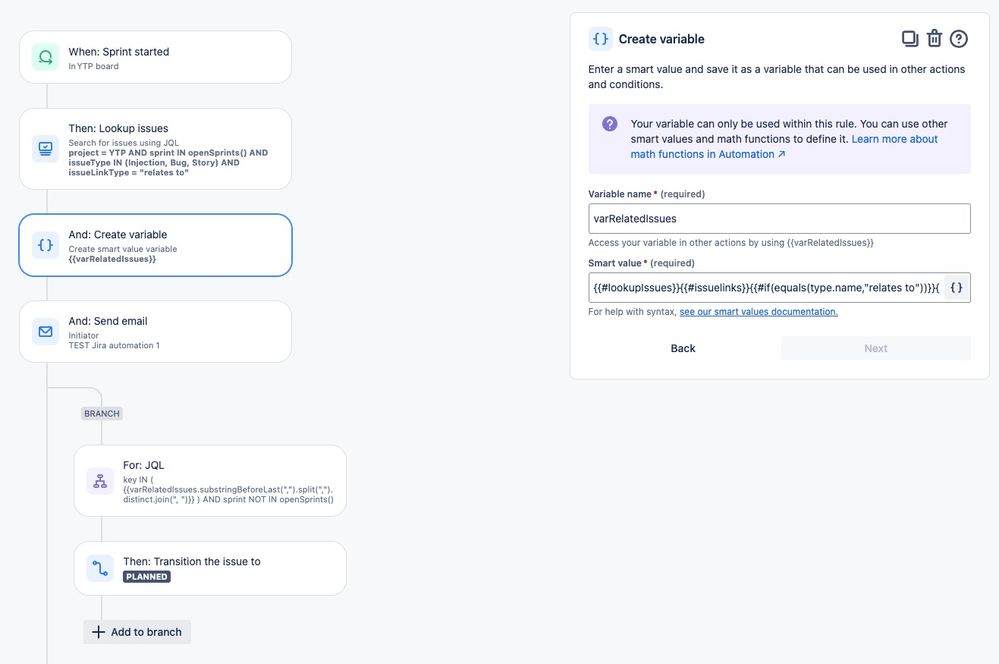

axl.verheul
August 21, 2024

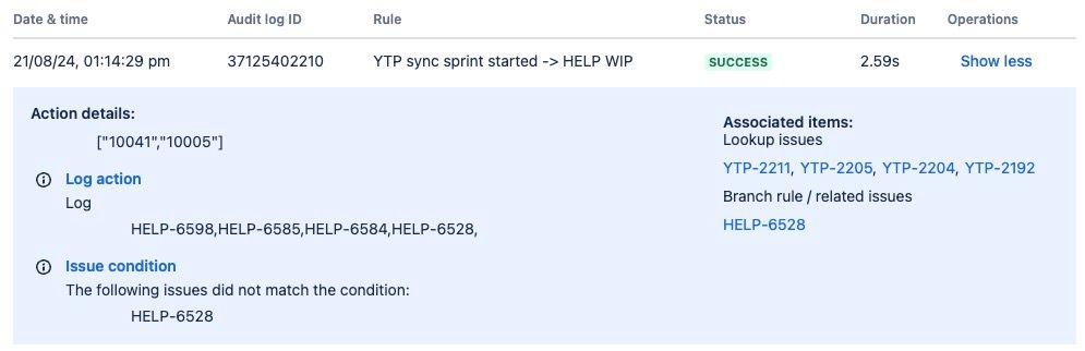

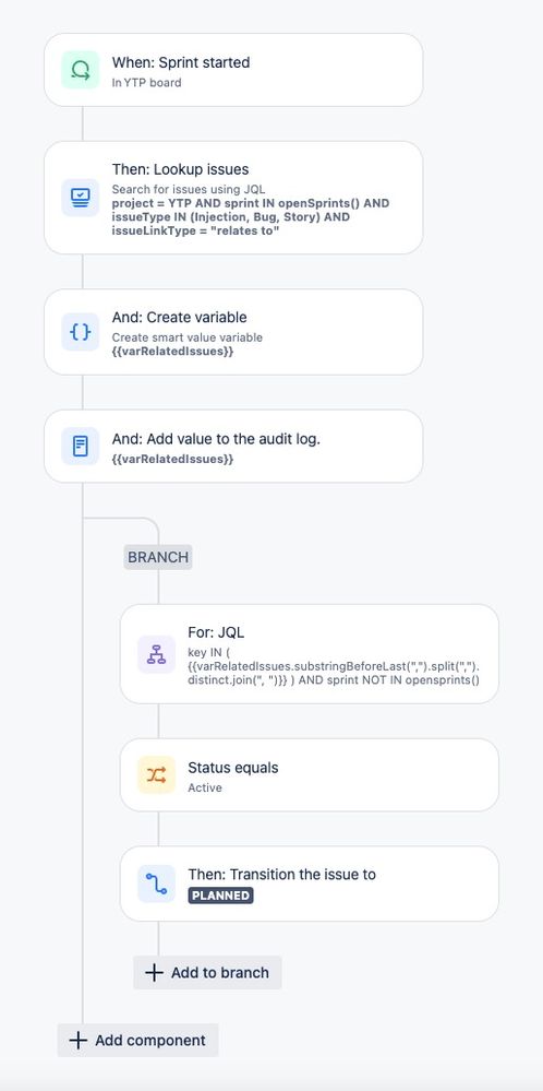

As requested, the audit log and full automation setup:
So good thing is, it is selecting all the correct HELP issues.
I added a check to make sure it's still Active (and not already In Progress).
The problem seems that it's not iterating over all the varRelatedIssues. Because HELP-6598 would also not pass the IF-condition and this is not being reported in the audit log.
Bill Sheboy
August 21, 2024
Sorry, my mistake: I tried to simplify the dynamic JQL and left off the possibility the linked issues may be in no sprints (rather than just not in the open sprint).
Please update the dynamic JQL for the branch to use this one:
key IN ( {{varRelatedIssues.substringBeforeLast(",").split(",").distinct.join(", ")}} )
AND key NOT IN ( {{lookupIssues.key.join(", ")}} ) AND status = "Active"
I added the status check at the end so you may remove the condition, making the rule more efficient.
One more thing to check: in the branch, is the option selected to...
Only include issues that have changed since the last time this rule executed
If so, that may exclude some issues.
