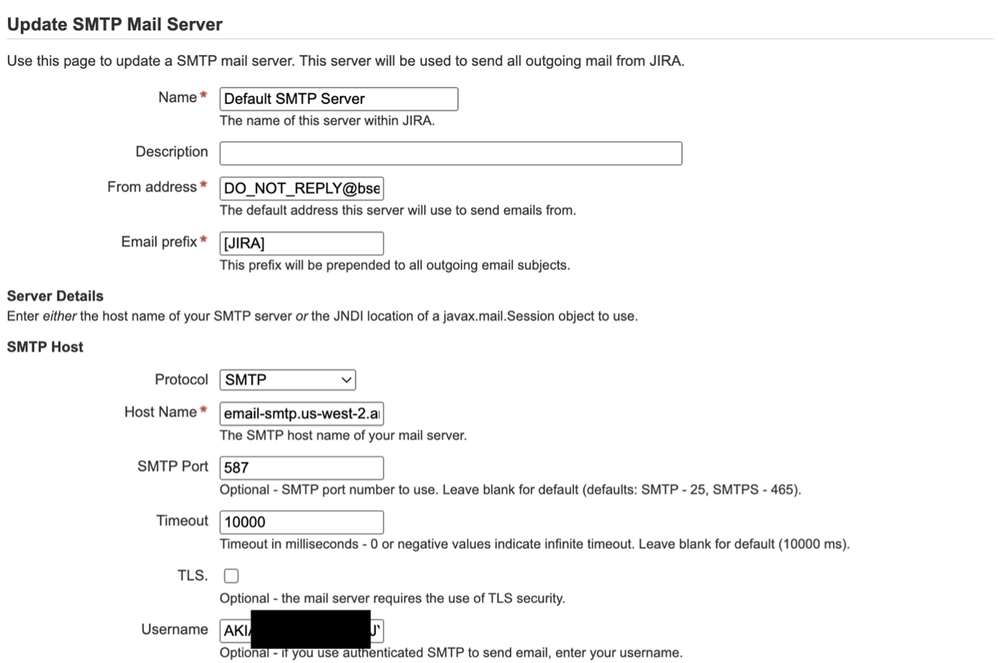

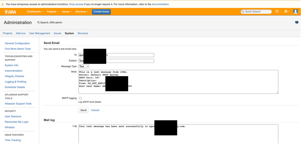

Thanks! Screenshots are very helpful!
Ok, so:
First off: The "Send Test Email" function does not change the From address, so it is not a good way to test your settings.
The From rewriting only happens with real notifications, so you will need to test with some fake issues or something.
Secondly: As I mentioned, the From address is always going to be <DO_NOT_REPLY@...> by default because this is how Jira is designed to work.
Ideally you would set up a POP or IMAP mailbox (in Outlook) for JIRA@yourcompany.com, and set that as the "From address".
If you set up the mail handlers correctly, replies to that address will automatically be added as comments to the appropriate issue:
(tick) Tip: You can configure JIRA's mail servers so that recipients of email notifications can simply reply to these messages and have the body of their replies added as comments to the relevant issue. To do this, simply set the From address in JIRA's SMTP mail server to match that of the POP or IMAP mail server's account being monitored. In most cases, this means having JIRA's SMTP and POP or IMAP mail servers use the same mail account. Details on how to configure JIRA to handle these emailed replies is mentioned below.
