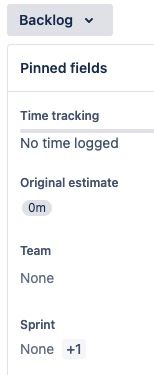

I have a pretty old bug that was aligned with a old sprint but was never completed in sprint and has just been hanging around.
I have since created a new plan with a new board (using Kanban for all our bugs now) and I can't get the bug to be visible in the Kanban backlog.
I have been successful with all the other issue items and I am wondering if its because this bug was in a sprint that belongs to a different plan.
How can I get it to be visible in the new plans backlog?

FYI- I have a plan & board that I am using for the 'sprint' work.  I can get this bug to show up here but I don't want it here but using your steps above, it shows up.
The problem is I have a separate plan & board for Kanban work.  I checked some of the configuration etc but I can't get this bug to show up on the Kanban board.  I has the correct label, other bugs show up as expected.  The only thing I can think of is that this particular bug was assigned to a sprint that has since completed.
Could it be because it has a sprint value that it won't show on a kanban board?  I just want to remove any link to a sprint but not sure how to do that or if it will even fix the problem.
