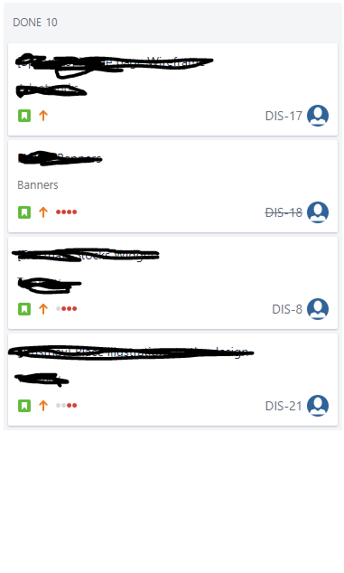

Do you know why sometimes the numbers of the issues that are closed are not crossed?

Hi Alexey! Thanks for your answer, but i don't understand it very well. As you can see in the image, the column I show are issues that have the status "Done". I don't modify the resolution field, only state (done). And some do it well and others don't and I do not know why...
Esther Lopez
October 8, 2018
In fact, I do not know where I should change the "resolution" field.

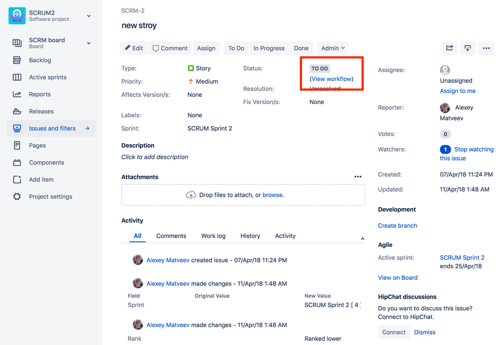

How can I see the workflow associated with a specific problem?
I know how to change the workflow of the project, but I do not know how to see the individual workflow of an issue.
Thanks in advance.
Esther
Alexey Matveev
October 8, 2018
Do not worry. Community is made for questions.
When you open an issue there is the View Workflow option:
