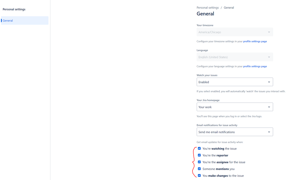

I was experiencing the same issue and just resolved it. I had not touched any of my notification settings, but discovered that my notifications for any activity (except for comments where I was tagged with @) had ceased since 4/25/24. I resolved this by going to my profile picture > personal settings > check the boxes in the screenshot.
This took me awhile to figure out because this screen clearly mentions email notifications. However, this resolved my bell notifications and they are now working as expected. I don't see any method to separate email notification and bell notification settings.

Hey thanks so much for the reply @Marshall Palfenier I see another comment below that might be able to distinguish email from in product!

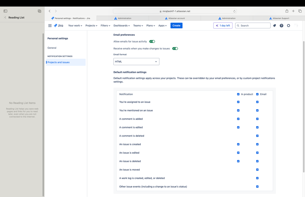

Hello, Good day. Try to access the following URL and check if you have the mentioned settings
https://sitename.atlassian.net/jira/settings/personal/notifications

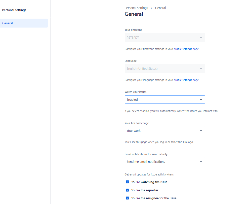

@Mohanraj Thangamuthu I dont see those advanced options.  ALl I see is:
Do you know how to access those settings?
