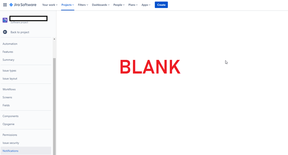

We have the issue that we cannot chose a Notification scheme. The page is broken.
Reason:
We switched in the Project Settings -> Notifications -> The notification scheme to "None".
And after you switch it, you dont have the option to switch back to another. The whole right frame stays blank:
And if you try to solve it from the other direction: You can create a new "Notification scheme", but there is no option to assign this to a Project.
This issue is reproducible.
How can I fix it?

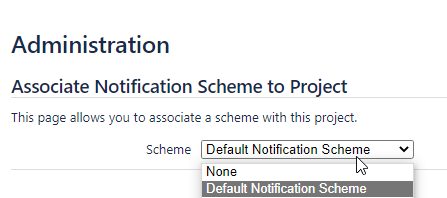

Hi Andreas,
you can use the direct link and assign another scheme.
https://[YOURINSTANCENAME].atlassian.net/secure/project/SelectProjectScheme!default.jspa?projectId=[PROJECTID]
f.e.
https://example.atlassian.net/secure/project/SelectProjectScheme!default.jspa?projectId=99999

Thank you very much for your feedback. I dont know what happened but not the blank page does not show up anymore. The menu is back.
But I tested the direct link and it works perfect! Thank you very much for this solution!
