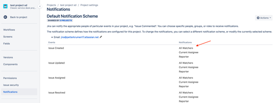

To configure notifications to be sent to agents when a new issue is created, you must add them to the "Issue Created" notification under project Settings > Notifications (Not customer notifications):
On this menu, you can configure the notifications that will be sent to your internal agents, the ones that will be working on the issues. For more details about it, you can check the documentation below:
