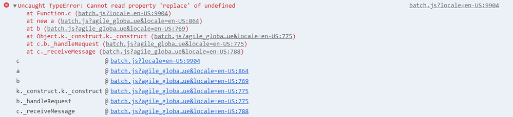

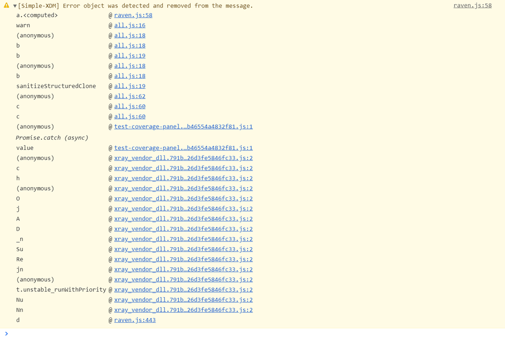

Thanks, @sudarshan  - Seems to be a JS issue: 1 error and 1 warning:

@Eric Gumulak Just curious if you figured out a solution to this. We are getting the same JS error as you are.

Seeing your issue, I suspect the below:
1. contact your Org Jira admin and check if there were any upgrades done to Jira.
2. is there a possibility of using different language? (other than english) in your servers
3. do you in your system, use multiple language?
4. If many in your org are getting this error, then its a server or deployment issue, else we need to think further. (contact Atlassian support).
5. finally do the traditional - Clear browser cache or other unrelated cache at the server (your admin will know) and try what happens. :)
