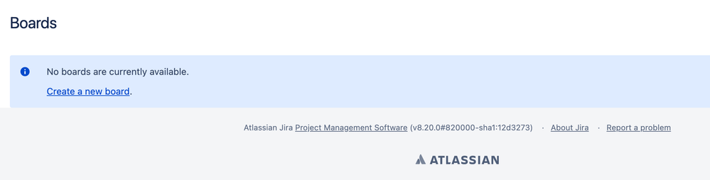

Thanks Trudy. Yes I re-indexed the data in the new one. It is working well now. But this time I cannot see the boards. Do you have any idea?

Were you following an Atlassian guide for migrating you Jira application and data from one server to another? If so please provide a link to the documentation you followed.
Erol Karaboga
February 20, 2023
Hi @Trudy P Claspill do you have any idea about that?
