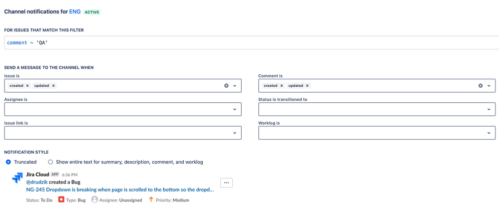

I am trying to send notifications in comments on a jira issue to a channel in slack.
This was initially working but now has stopped ?
My Jira app on slack is still working and shows notification in messages along with all the other Jira activity.
My slack channel filter is configured only to show comments tagged with QA has just stopped working ?
In JIRA the Slack Integration tab -> has this filter defined

I just deleted and re-created the filter in Jira and it looks to be working, however I would like to understand what could cause a filter to stop

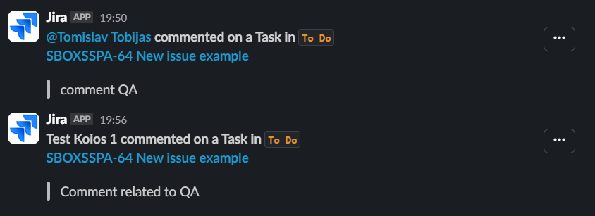

@qonrobert hmm.
I've just tested it on a couple of issues with one integration to Free Slack instance and it seems to be working fine.
Whenever there's a comment on an issue that contains the string 'QA' and the issue is updated or a comment is updated or created, a notification arrives in the designated Slack channel. No matter who created or updated the comment.
Is your Slack on a paid or Free version? Also, is Jira on Free or paid plan? Although, this shouldn't necessarily affect the behavior, as you say notifications are coming to a channel whenever you create or update a comment.
So, to confirm, whenever you update any of the issues which match the following filter: comment ~ 'QA', meaning if you would check issues https://sitename.atlassian.net/issues/?jql=comment%20~%20%27QA%27 (+ let's say you add a parameter for project)> only issues which you update will appear as notifications and whenever someone else updates those, these notifications are not received?
