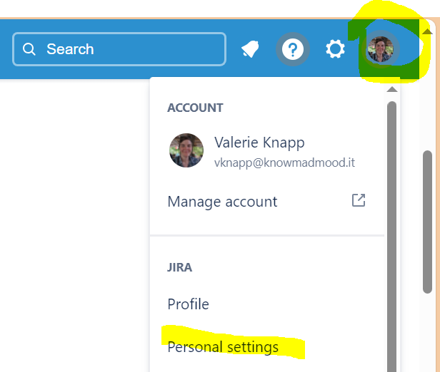

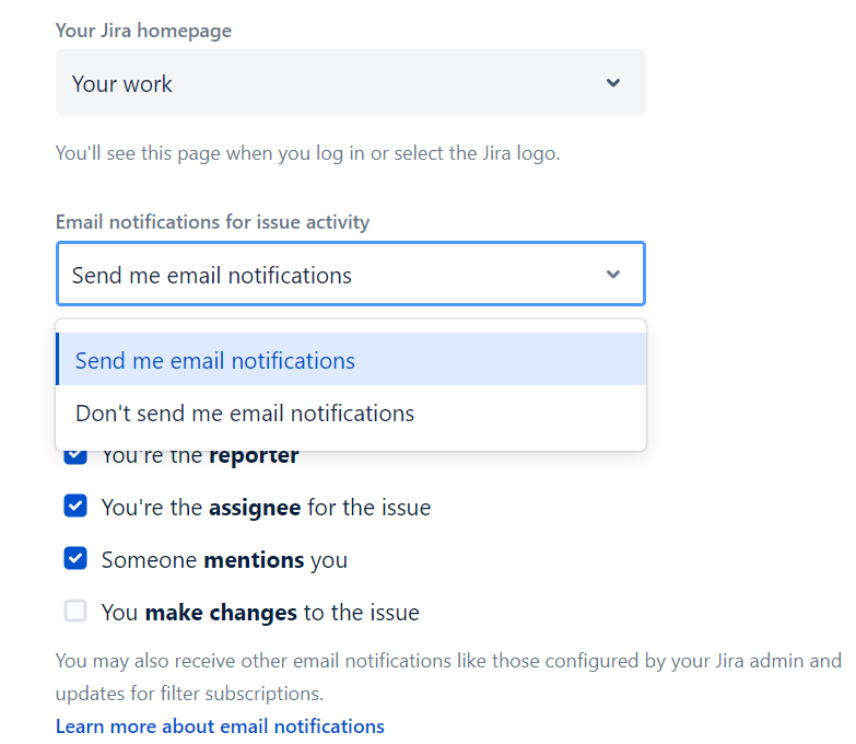

Hi @abhishek.s-j , welcome to the community and thanks for your question.
Please check, in Jira, your 'Personal settings', here
You might have all the email notifications switched off by default and would need to customize or switch back on the ones you want-
Please check these settings and let us know if this solves the issue.

abhishek.s-j
September 20, 2023
Hi @Valerie KnappI checked this and have selected send me email notifications already.

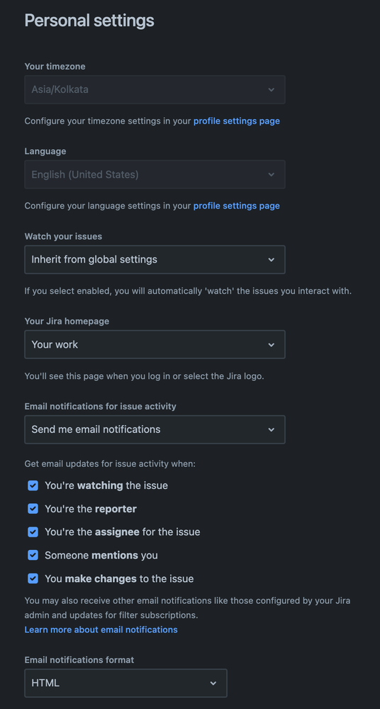

abhishek.s-j
September 20, 2023
So here is my current settings, despite this I am not receiving email notifications from JIRA.
Valerie Knapp
September 20, 2023
Hi @abhishek.s-j , have you performed any actions in Jira for which you should get a notification? Have you checked the notification scheme for the project and what their configurations are?
