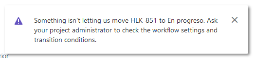

1. Error message when moving ticket from status 'POR HACER' to 'EN PROGRESO' directly on the board.

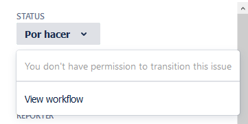

2. Message when moving directly changing status inside the ticket.
3. At this point, maybe someone modified my role? No. Still Jira administrator.

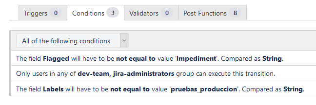

4. Check transition contidions.
5. Compare transition conditions with what I already have in the ticket.

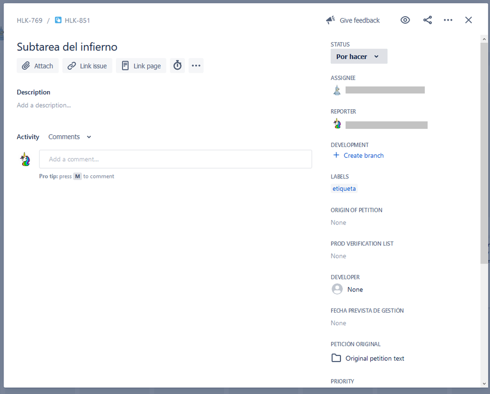

* Ticket is not flagged, so 'Flagged' does not have 'Impediment' value.
* I belong to jira-administrators team.
* Labels does not have 'pruebas_produccion' label, just 'etiqueta' label as a test to assure the problem was not the lack of labels.
6. Anyway, I tried removing all transition conditions. Same error message when trying to transit the ticket.

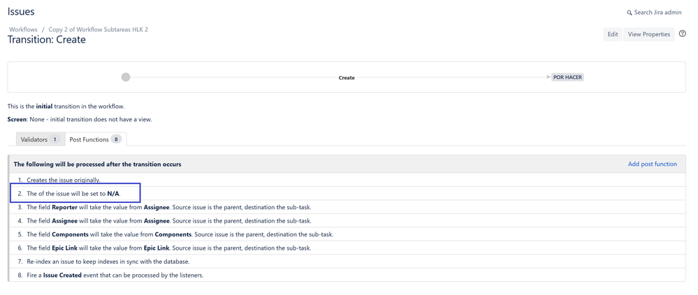

After a bit help of Atlassian support, I found out what the problem was.
Checking post-functions when a new subtask is created, I found that there was a function for a attribute that did not exist anymore, so I remove it and subtasks workflow is working fine.
I hope this clarification will help to anyone with same Jira problems.

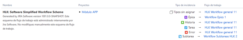

Did you verify your issuetype schemes ?
Is your issuetype subtask following the same scheme as all other issuetypes in your project ?

Anyway I already checked it too. I took into account that for the changes I mentioned in the post.
