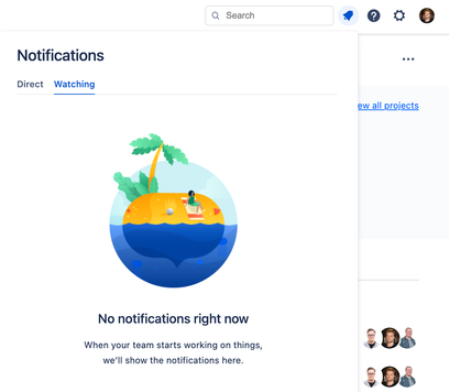

I don't get any notifications when watching a ticket. No email nor push. No matter if I'm turning the watcher option myself or I'm added by somebody else. The "Watching" section in notifications is empty, only getting the "Direct" notifications. Do you know how to enable this option?

Hello @Dawid Kowalski
Welcome to the community.
Do you know if any other users are receiving notifications?
Have any activities occurred on tickets you are watching that you know for a fact should have generated a notification to you?
Are you watching tickets in Classic projects or Next Gen projects? In Classic projects there will be a Notification Scheme associated with the project that determines which activities will generate a notification and to whom that notification will be sent. That will affect whether or not any notifications are sent to you for issues in that project.

Thanks for the answer! We use Classic projects, the notifications for ticket Watchers are configured in Notification Scheme and the other users don't experience this problem. I'm the only member of the organization that reported such issue.
I confirm that there were tickets with activities that should generate notifications.

Have you checked your Personal Settings to see that you have not disabled notifications?
Can you have your JIRA Administrator use Notification Helper to confirm that you should've received notification for the activity?

I can confirm the notifications are not disables and that the Admin confirmed I should've received the notification.

Solution for company managed project:
I had the same issue where I was getting notifications from one project but not from the other and I found a solution.
In project settings and under notification settings, I noticed there was no notification scheme assigned to the project. I just assigned one to it or you can manually add/edit the notification type.
Hope this helps!
