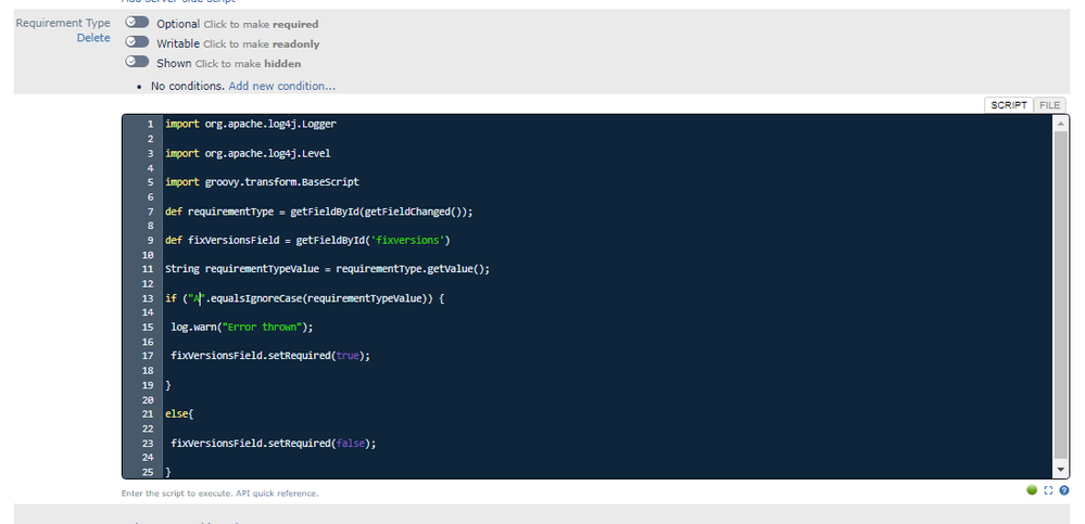

Manjupriya T
June 15, 2023
Hi @Fabio Racobaldo _Catworkx_ ,
Thanks for getting back on this issue.
I have tried out your script, but that does not help. Fix version field is not set as mandatory though "Requirement Type" field value selected is "A".
Is there specific function that should be used to make the field mandatory before the issue created event fires?
Thanks,
Manjupriya T

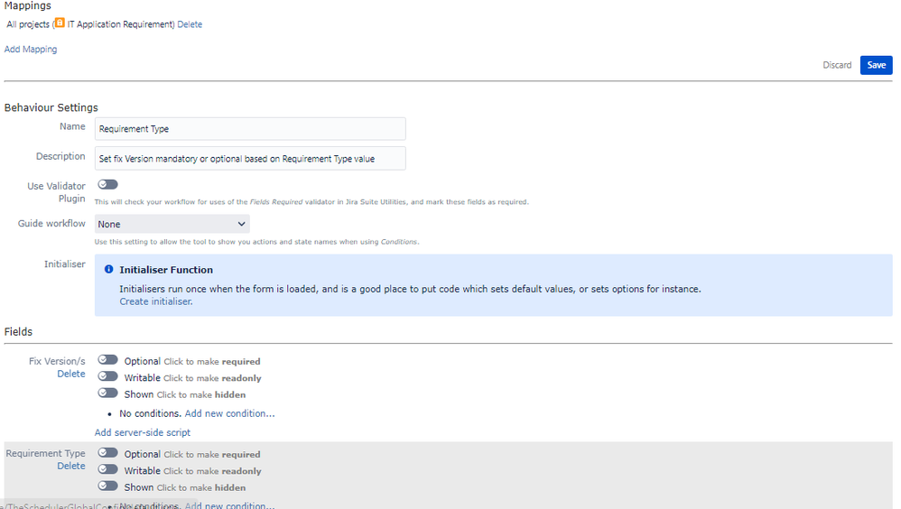

June 15, 2023
Hey @Manjupriya T ,
are you sure that you setup behaviour correctly with a correct mapping to your project/issue type and adding my code to Requirement Type field? Please could you share behaviour configuration screenshot?
Fabio
Manjupriya T
June 15, 2023
I have the correct mappings and the script have been added to the correct field.
Thanks
June 15, 2023
What field type is RequirementType?
Manjupriya T
June 15, 2023
It's Single select drop down type.
Thanks,
Manjupriya T
