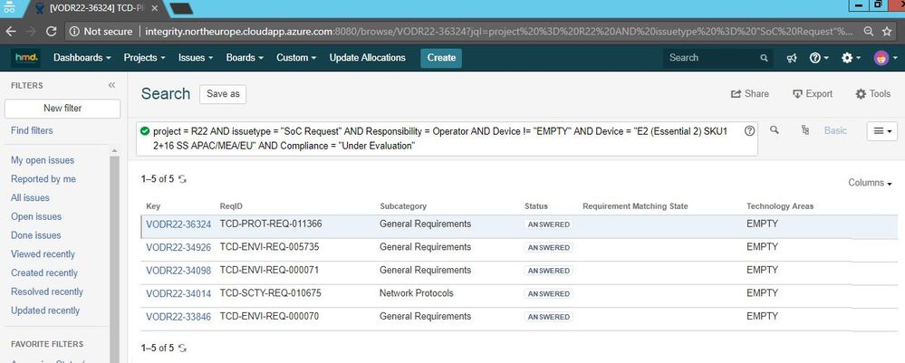

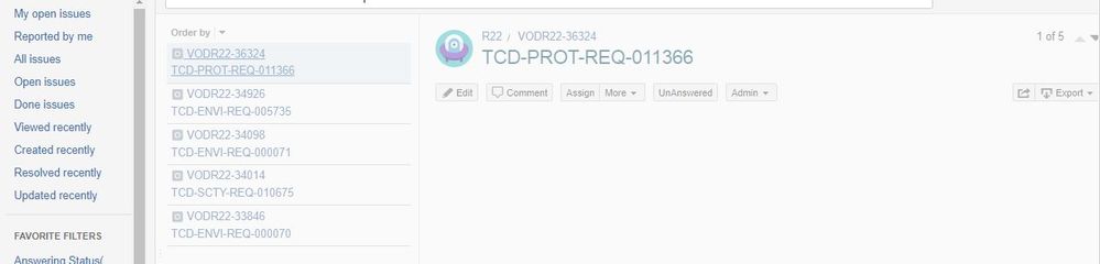

I was reporting i was not able to click on the issues and access it. but the same issues are not accessible in detailed view itself . But from list view its visible properly but again for opening those issues i need to open in new window.
