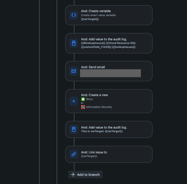

I am creating an automation that part of the flow will search for some stories based on criteria and then create one story in a different project that combine information from all the found stories. After that I would like to link the new story to all the stories that I created it from. So the linking part as what is not working. I am able to get the list of all the stories from the JQL an store in in the variable, but for some reason when I use Link Issue action, only the first story in the list get to be linked. I would appreciate any suggestions.

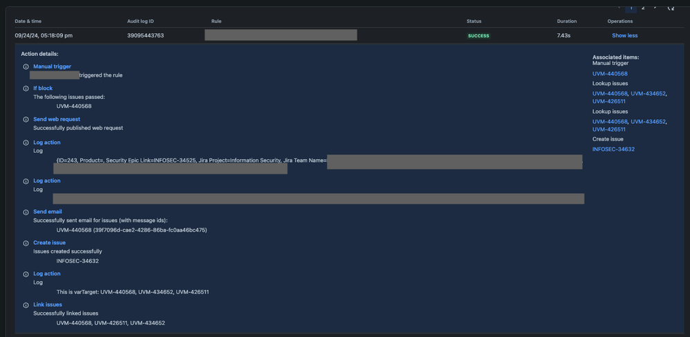

Can you show us the entire rule, please?

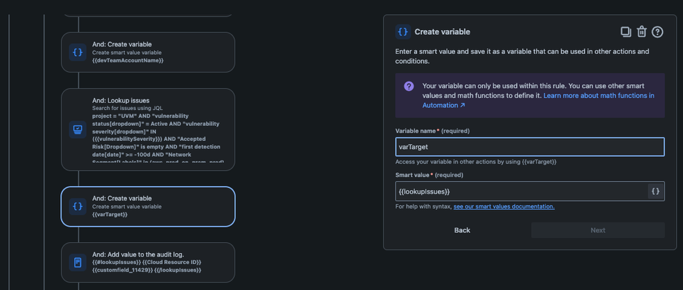

Also, please show us the details for the creation of the varTarget variable.
And, please show us the output in the rule execution log for the execution of this rule.

Thank you for your response. I am attaching items 2 and 3. I am not sure anything above that will help to debug the issue. As you can see in the screenshot, I am setting the varTarget to the value of lookupIssues, and in the log I can see that it is set correctly.

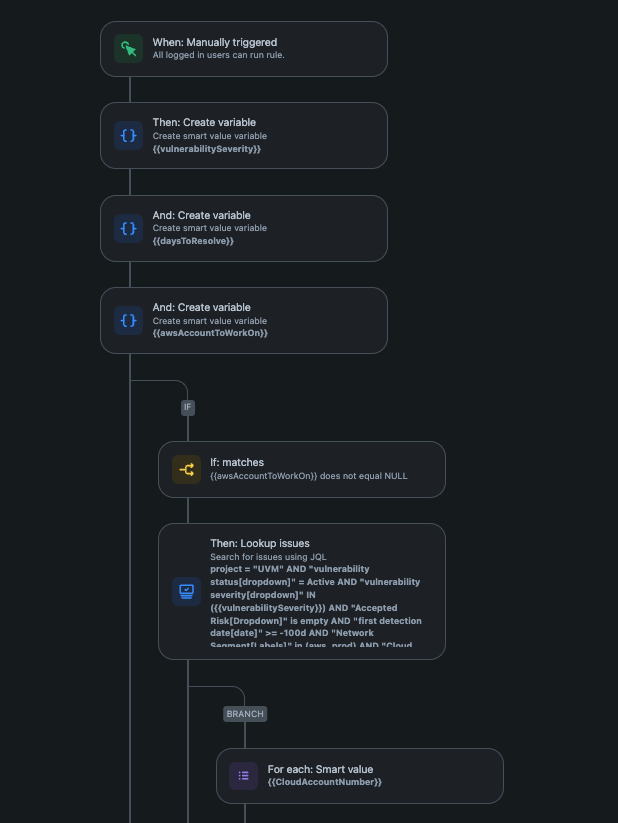

@Trudy P Claspill attached the complete flow.

My initial suggestion was going to be to use a branch to iterate through the results of your Lookup Issues action and link each one to the newly created issue. Unfortunately you rule is already in a branch at that point, and you cannot nest a branch within a branch.
