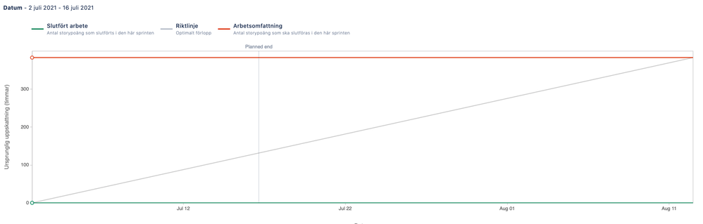

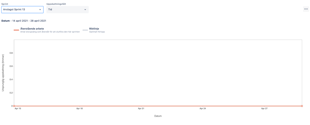

Skärmavbild 2021-08-12 kl. 11.31.39.pngSkärmavbild 2021-08-12 kl. 11.32.04.png
Please see attached screenshots

Both of the reports you are showing appear to be based on time.
The first graph shows that time estimates have been entered on the issues (the red line), but no time has been entered in the issues for work completed (green line) and/or the issues have not been set to a "done" status.
The second graph, with the red line along the bottom, appears to be the Burnup Chart with Original Time Estimate set as the metric for the chart. Is that correct? If so, the red line is indicating that you have not entered any values for the Original Estimate in the issues you have included in the sprint.
For sprint reports (burn up or burn down) based on time to provide data you need to
- Enter Original Estimates (time) in each issue
- Log Work (time) against the issues as work is done
- Set the issues to the "done" status when the work is completed.
