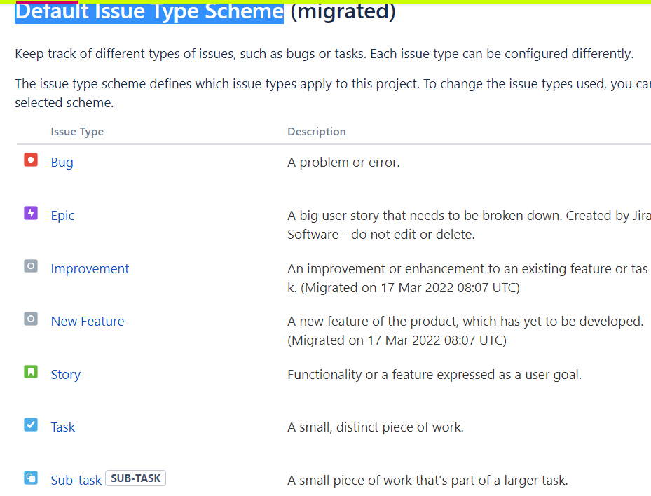

Thanks for the response.  I verified that issue type='Task' is a part of the: Issue Type Scheme which we migrated from JIRA Server 2 months back. This scheme is being used for all our  projects on JIRA cloud. And this is here:

@Priyanka Soni I am assuming that this occurs in all projects when trying to create a task.  Do you have any other schemes that were not migrated?  Do you have project that was only created in cloud?  Can you create a task in that project?
If you can create a task in the cloud project I would suggest creating a new issue type scheme with the issue the same as above and applying it to the project in question to see if this resolves the issue.  It might be something is corrupt from the migration.  If that does not resolve the issue you will need to contact support.
