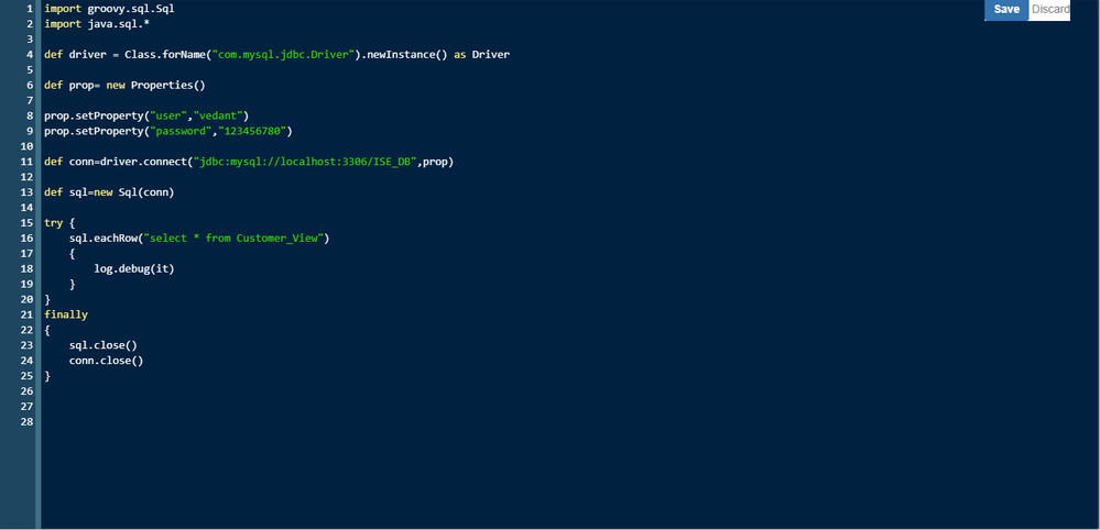

I want to connect to MySQL DB by using script runner. I applied behavior for this on a custom field. I paste the driver jar file in <jira-install>\lib and also studied this scriptrunner tutorial https://scriptrunner.adaptavist.com/latest/jira/recipes/misc/connecting-to-databases.html . But I still getting this error. Am I doing it in right way?
script:-
def driver = Class.forName("com.mysql.cj.jdbc.Driver").newInstance() as Driver
def prop= new Properties()
prop.setProperty("user","admin")
prop.setProperty("password","123456780")
def conn=driver.connect("jdbc:mysql://localhost:3306/ISE_DB",prop)
def sql=new Sql(conn)
try {
sql.eachRow("select count(*) from Customer_View") {
log.debug(it)
} finally {
sql.close()
conn.close()

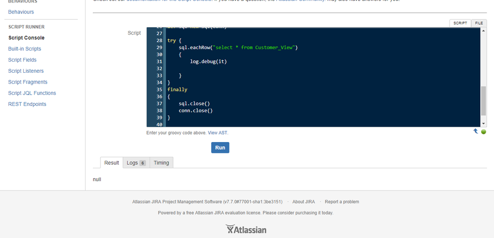

I think that the result tab shows an output of the last command executed or last variable.

as shown in screenshot I imported the required package.

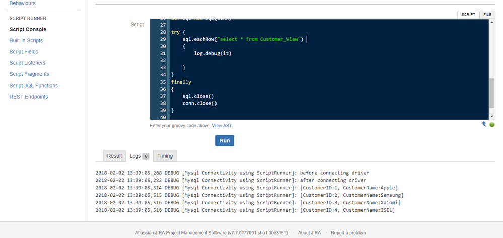

Yes, the script is running on console with desired output but it's not running when I tried to run through behaviors
in the logs, I am getting output but in the result tab, I am not getting output. Do I need to write any return statement? so that it will print
