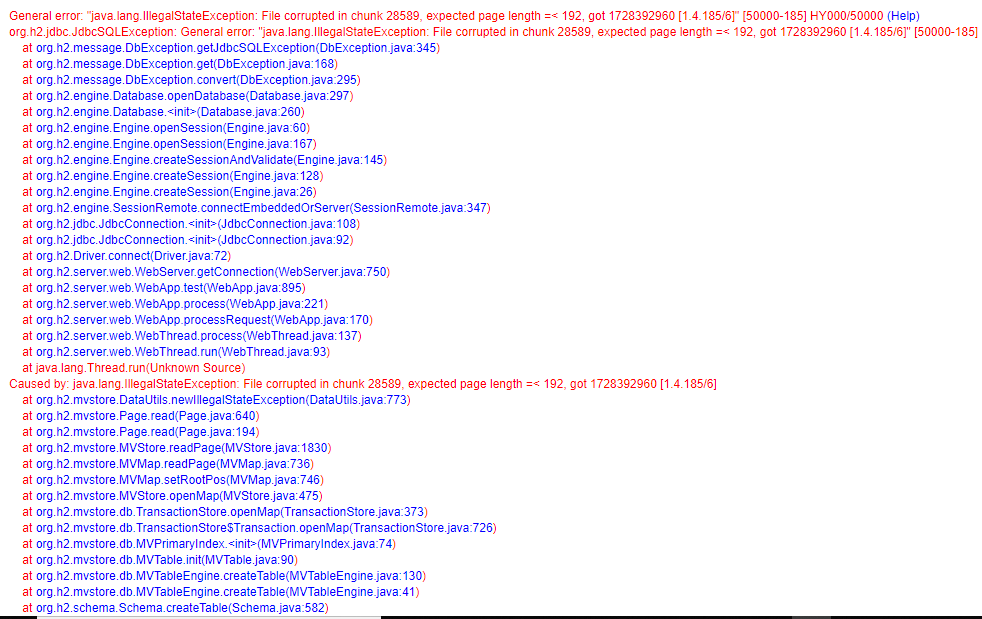

2019-06-04 11:27:43,678 JIRA-Bootstrap INFO [c.a.j.config.database.SystemDatabaseConfigurationLoader] Reading database configuration from C:\Program Files\Atlassian\Application Data\JIRA\dbconfig.xml
2019-06-04 11:27:44,059 JIRA-Bootstrap ERROR [c.a.config.bootstrap.DefaultAtlassianBootstrapManager] Could not successfully test your database:
org.h2.jdbc.JdbcSQLException: General error: "java.lang.IllegalStateException: File corrupted in chunk 28589, expected page length =< 192, got 1728392960 [1.4.185/6]" [50000-185]

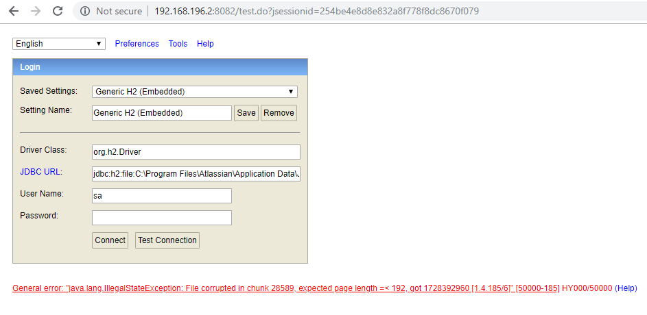

1. This is not first time I am connecting to DB, it was properly working earlier but due to holidays, installed JIRA server was off for 3 days, but when we try to run again it started to give Database connectivity issue.
2. OS is Windows 10 and database is H2
3. Below steps I tried to resolve it, but still same issue
i. I have deleted files: .jira-home.lock, .bundled-plugins and .osgi-plugins by stopping and restarting Atlassian JIRA service
ii. Deleted Cache folder:  Atlassian\Application Data\JIRA\caches
Please refer below screenshot
This one confused me because if i would have to guess, it seems that there is a connection problem.
But then you have following entry that looks like you have a corrupted database.
So knowing what happend now it seems to me that you indeed have a corrupted database.
If you are using it as a production instance, I presume (hope) you have a backup of the data because this can not be fixed for as far as i know.
You should install a decent database like MySQL or Postgres. Connect Jira to the new database and import your backup again.

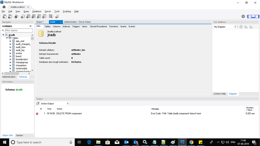

Hi Dave, now I am able to connect JIRA with MySQL, but while importing data it is throwing exception as
SQL Exception while executing the following:DELETE FROM component (Table 'jiradb.component' doesn't exist)

Hi Dave, its already added lower_case_table_names = 1 in my.cnf file
also kindly find screenshot of MySQL Db
Dave Bosman _Inetum_
June 6, 2019
Hi @Abhijit Dongre
I see you use utf8mb4.
This should be utf8
Regards
Dave
Abhijit Dongre
June 6, 2019
Hi Dave, when I earlier created database using utf8, then it was throwing error as 'your database doesn't support utf8mb4, so I created new one.
Please guide, shall I execute below command
ALTER SCHEMA `jiradb` DEFAULT CHARACTER SET utf8 DEFAULT COLLATE utf8mb4_bin;
